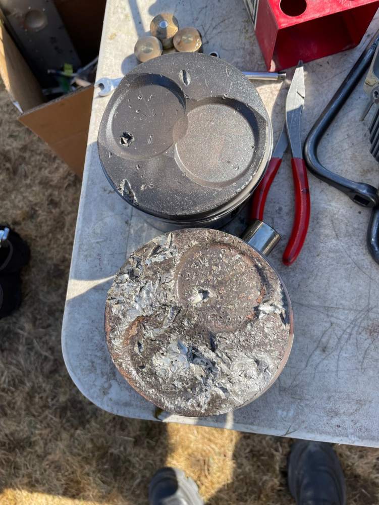

LBM Posted April 17 Report Posted April 17 20 hours ago, AndreiC said: I wonder what can cause an engine failure in cruise like this. The plane was flown very regularly. Fuel exhaustion? Some other mechanical failure? My ‘64 M20E had engine failure in flight a couple of months ago. No warning, in cruise at 4500’ there was a loud “POP” followed by sad engine noises and partial power. After the ensuing forced landing at nearest airport (itself quite a story) we identified the proximate cause, #3 exhaust valve lost its head. 1 Quote
AndreiC Posted April 17 Report Posted April 17 12 minutes ago, LBM said: My ‘64 M20E had engine failure in flight a couple of months ago. No warning, in cruise at 4500’ there was a loud “POP” followed by sad engine noises and partial power. After the ensuing forced landing at nearest airport (itself quite a story) we identified the proximate cause, #3 exhaust valve lost its head. Interesting experience, I guess (to say the least). Was the engine toast, or did it just need a new cylinder? For the experts out there, is such a valve failure caused by high operating temps, or manufacturer's defect? How many hours were on that cylinder? Quote

LBM Posted April 18 Report Posted April 18 10 hours ago, AndreiC said: Interesting experience, I guess (to say the least). Was the engine toast, or did it just need a new cylinder? For the experts out there, is such a valve failure caused by high operating temps, or manufacturer's defect? How many hours were on that cylinder? Toast, as far as I’m concerned. Trashed two jugs. The engine kept running with the #3 exhaust valve gone, and that beat the crap out of everything in that cylinder. With the exhaust valve never closing it got pressurized by back pressure from the other cylinders. The valve head was beaten into pieces, and when the intake valve opened some of those pieces were blown upstream into the intake manifold. From there a couple of them found their way into #4 cylinder and trashed it as well. Despite all that the engine continued to run until pulled to idle after landing, when it immediately died. I’m assuming the valve hung or stuck instead of closing and the piston knocked the head off. Could’ve just had the head break off for unknown reasons but that seems crazy, unrealistic. Don’t have logs to check if that jug was ever replaced, the logs went with the engine for overhaul, but I don’t recall changing it since I’ve owned the plane (2.5 years). Engine was midtime on service hours, about 1100 iirc, so I’m assuming that was time in service on that valve. Although it could’ve been more… The local mechanic that helped me diagnose the failure recommended replacing all four jugs and returning it to service. Thing is, approx 1100 service hours but last overhaul was at least 35 years ago. And that may have been IRAN after prop strike not a full overhaul (logs show extensive engine work in 1989 but do not include the word “overhaul”; airframe logs show nose gear repairs and belly skin replacement at the same time). In light of that I decided to bite the bullet and get it overhauled. It’s out getting a full overhaul now. 2 Quote

Yetti Posted Saturday at 02:50 PM Report Posted Saturday at 02:50 PM On 4/17/2025 at 11:09 PM, LBM said: Toast, as far as I’m concerned. Trashed two jugs. The engine kept running with the #3 exhaust valve gone, and that beat the crap out of everything in that cylinder. With the exhaust valve never closing it got pressurized by back pressure from the other cylinders. The valve head was beaten into pieces, and when the intake valve opened some of those pieces were blown upstream into the intake manifold. From there a couple of them found their way into #4 cylinder and trashed it as well. Despite all that the engine continued to run until pulled to idle after landing, when it immediately died. I’m assuming the valve hung or stuck instead of closing and the piston knocked the head off. Could’ve just had the head break off for unknown reasons but that seems crazy, unrealistic. Don’t have logs to check if that jug was ever replaced, the logs went with the engine for overhaul, but I don’t recall changing it since I’ve owned the plane (2.5 years). Engine was midtime on service hours, about 1100 iirc, so I’m assuming that was time in service on that valve. Although it could’ve been more… The local mechanic that helped me diagnose the failure recommended replacing all four jugs and returning it to service. Thing is, approx 1100 service hours but last overhaul was at least 35 years ago. And that may have been IRAN after prop strike not a full overhaul (logs show extensive engine work in 1989 but do not include the word “overhaul”; airframe logs show nose gear repairs and belly skin replacement at the same time). In light of that I decided to bite the bullet and get it overhauled. It’s out getting a full overhaul now. Seems old enough to be of the time they were switching from old valves that would break to sodium filled valves and such. Might look for an SB or AD Quote
A64Pilot Posted Saturday at 05:24 PM Report Posted Saturday at 05:24 PM (edited) Sodium filled valves have been around for a while, the engine in The Spirit of St. louis I believe had them for example. https://airandspace.si.edu/collection-objects/wright-whirlwind-j-5a-b-radial-engine/nasm_A19791508000 Most valves are two piece that is the head and stem, often if there is a failure it’s at the joint, most often a failure results from the piston hitting the valve, as they aren’t aligned this bends and sometimes breaks the valve, on aircraft I believe the most common reason for the piston to hit a valve is a stuck valve, very rarely I guess it could be a broken spring etc. ‘The piston staying in one piece is rare I think, often it gets broken, rod goes through the crankcase and of course the engine stops, if yiu break a valve and the engine keeps running, buy a Lottery ticket, because that was your lucky day. Edited Saturday at 05:28 PM by A64Pilot Quote
