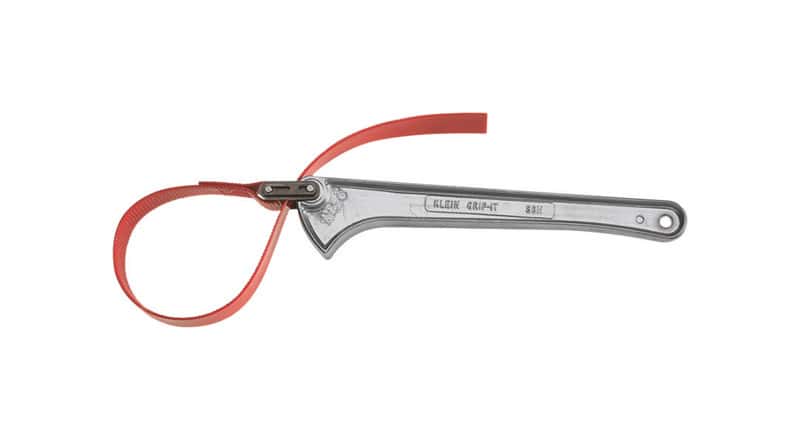

JimB Posted June 5, 2023 Report Posted June 5, 2023 I have had success with using a strap wrench on both cars and aircraft when needed. 2
rotorman Posted June 6, 2023 Author Report Posted June 6, 2023 19 hours ago, JimB said: I have had success with using a strap wrench on both cars and aircraft when needed. The problem I would have had with this kind of tool is the lever arm is too short. My filter was really stuck. My 18 inch slip joint plyers have a lever arm of about 12 inches. It took both hands on the plyers and pulling a couple of times with all I had to finally break it loose. I applied so much force that the entire filter distorted. It had to have been 150 to 200 ft-lbs. Truly an extreme case. Maybe the installer didn't use any lube.
JimB Posted June 6, 2023 Report Posted June 6, 2023 58 minutes ago, rotorman said: The problem I would have had with this kind of tool is the lever arm is too short. My filter was really stuck. My 18 inch slip joint plyers have a lever arm of about 12 inches. It took both hands on the plyers and pulling a couple of times with all I had to finally break it loose. I applied so much force that the entire filter distorted. It had to have been 150 to 200 ft-lbs. Truly an extreme case. Maybe the installer didn't use any lube. Fully understand. The problem is that the recommended torque on these filters is pretty high at 16-18 ft/lbs.
EricJ Posted June 6, 2023 Report Posted June 6, 2023 1 hour ago, rotorman said: The problem I would have had with this kind of tool is the lever arm is too short. My filter was really stuck. My 18 inch slip joint plyers have a lever arm of about 12 inches. It took both hands on the plyers and pulling a couple of times with all I had to finally break it loose. I applied so much force that the entire filter distorted. It had to have been 150 to 200 ft-lbs. Truly an extreme case. Maybe the installer didn't use any lube. In my experience the pre-lubed Tempest filters are hardest to take off if you *do* use lube. I failed to wipe the oil off the sealing surface once and had a very, very hard time getting that one off. If you just follow the instructions and not lube it, they're generally easy to get off. If they do get sufficient oil on them they're harder to remove. Strap wrenches work well, but a 1" box-end wrench is my go-to when it gets difficult to get off. I bought a new Ford Ranger that has the oil filter in an odd location, and while I managed to get a strap filter in there to get it off, I discovered that a lot of people use these: https://www.amazon.com/dp/B0002SR53A Applying removal torque tightens the grip on it, like a strap wrench does, but this may provide access if there isn't space for a strap wrench or other tool. I haven't used it yet, but it might work on an airplane as well.
GeeBee Posted June 6, 2023 Report Posted June 6, 2023 I have several strap wrenches including one like JimB's above but the one that does the best, weirdly, is the Penzoil strap wrench made out of plastic. I don't know why, but if I can't get a filter to budge, it always gets the job done. I can't explain it but it just works really good and it's cheap! https://www.amazon.com/Custom-Accessories-19425-Wrench-Pennzoil/dp/B0058I0T7S/ref=sr_1_5?hvadid=516871023049&hvdev=c&hvlocphy=9010778&hvnetw=g&hvqmt=e&hvrand=15641243085195409308&hvtargid=kwd-1257502036018&hydadcr=29035_10165969&keywords=pennzoil+strap+wrench&qid=1686067340&sr=8-5 1
EricJ Posted June 6, 2023 Report Posted June 6, 2023 28 minutes ago, GeeBee said: I have several strap wrenches including one like JimB's above but the one that does the best, weirdly, is the Penzoil strap wrench made out of plastic. I don't know why, but if I can't get a filter to budge, it always gets the job done. I can't explain it but it just works really good and it's cheap! https://www.amazon.com/Custom-Accessories-19425-Wrench-Pennzoil/dp/B0058I0T7S/ref=sr_1_5?hvadid=516871023049&hvdev=c&hvlocphy=9010778&hvnetw=g&hvqmt=e&hvrand=15641243085195409308&hvtargid=kwd-1257502036018&hydadcr=29035_10165969&keywords=pennzoil+strap+wrench&qid=1686067340&sr=8-5 They're about half that at Harbor Freight. Same stuff. I use plastic ones as well, but I don't remember where I got them. https://www.harborfreight.com/rubber-strap-wrench-set-2-piece-69373.html 1
