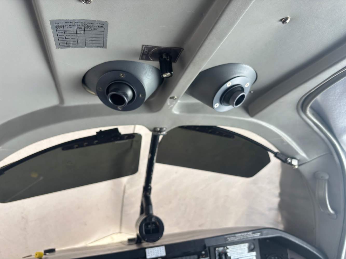

Robm Posted May 2, 2025 Report Posted May 2, 2025 Update phase 1 (front) done. They look great and feel like a huge upgrade. I installed them as owner produced parts (14 CFR 21.9(a)(5)) and preventative maintenance (14 CFR 43.3(g) and Appendix A(c)). I think these will last longer than my head liner. Next step, back seats...

TaildraggerPilot Posted May 27, 2025 Report Posted May 27, 2025 On 3/15/2025 at 10:27 AM, AH-1 Cobra Pilot said: Mine have been working for several years now, so I am reasonably confident they are good. I can make either the vents or the eyeball fixtures. PM me if you are interested. Do the eyeball vent adapters fit reasonably well into the existing air plenum system?
EricJ Posted May 28, 2025 Report Posted May 28, 2025 On 3/15/2025 at 7:27 AM, AH-1 Cobra Pilot said: Mine have been working for several years now, so I am reasonably confident they are good. I can make either the vents or the eyeball fixtures. PM me if you are interested. Oh, I missed these when you first posted them. How much are you thinking for the eyeball fixtures?
AH-1 Cobra Pilot Posted May 28, 2025 Author Report Posted May 28, 2025 2 hours ago, TaildraggerPilot said: Do the eyeball vent adapters fit reasonably well into the existing air plenum system? They attach with one bolt through the existing hole the old vent assembly uses.
TaildraggerPilot Posted May 30, 2025 Report Posted May 30, 2025 On 5/27/2025 at 9:22 PM, AH-1 Cobra Pilot said: They attach with one bolt through the existing hole the old vent assembly uses. I’m assuming the adapter is mounted first, then the eyeball vent ($$$ from Spruce) is attached.
AH-1 Cobra Pilot Posted May 30, 2025 Author Report Posted May 30, 2025 2 hours ago, TaildraggerPilot said: I’m assuming the adapter is mounted first, then the eyeball vent ($$$ from Spruce) is attached. Yes. It is too difficult to reach the hardware, otherwise. I do recommend attaching and removing the vent to the adapter prior to installing the adapter, just to ensure it goes in easier once you have it on the ceiling.
TaildraggerPilot Posted May 30, 2025 Report Posted May 30, 2025 4 hours ago, AH-1 Cobra Pilot said: Yes. It is too difficult to reach the hardware, otherwise. I do recommend attaching and removing the vent to the adapter prior to installing the adapter, just to ensure it goes in easier once you have it on the ceiling. Ok, well I’m interested
