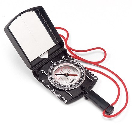

On 3/14/2020 at 6:18 PM, Yetti said:
I carry one of these.   hard to read in a moving environment, but pretty reliable.
Product image for Black
Hold that thing in your hand with your Apple Watch on your wrist and you’re gonna be very reliably off course!:)
luckily I never bought into the Apple overpriced hype.   Guess I could test my FitBit and see if it is TSO compliant :-)   Since I have a vertical card compass it would be interesting to see if it has the same issue.   I was surprised that the vertical card compass needs the vibration from the plane to work properly.
