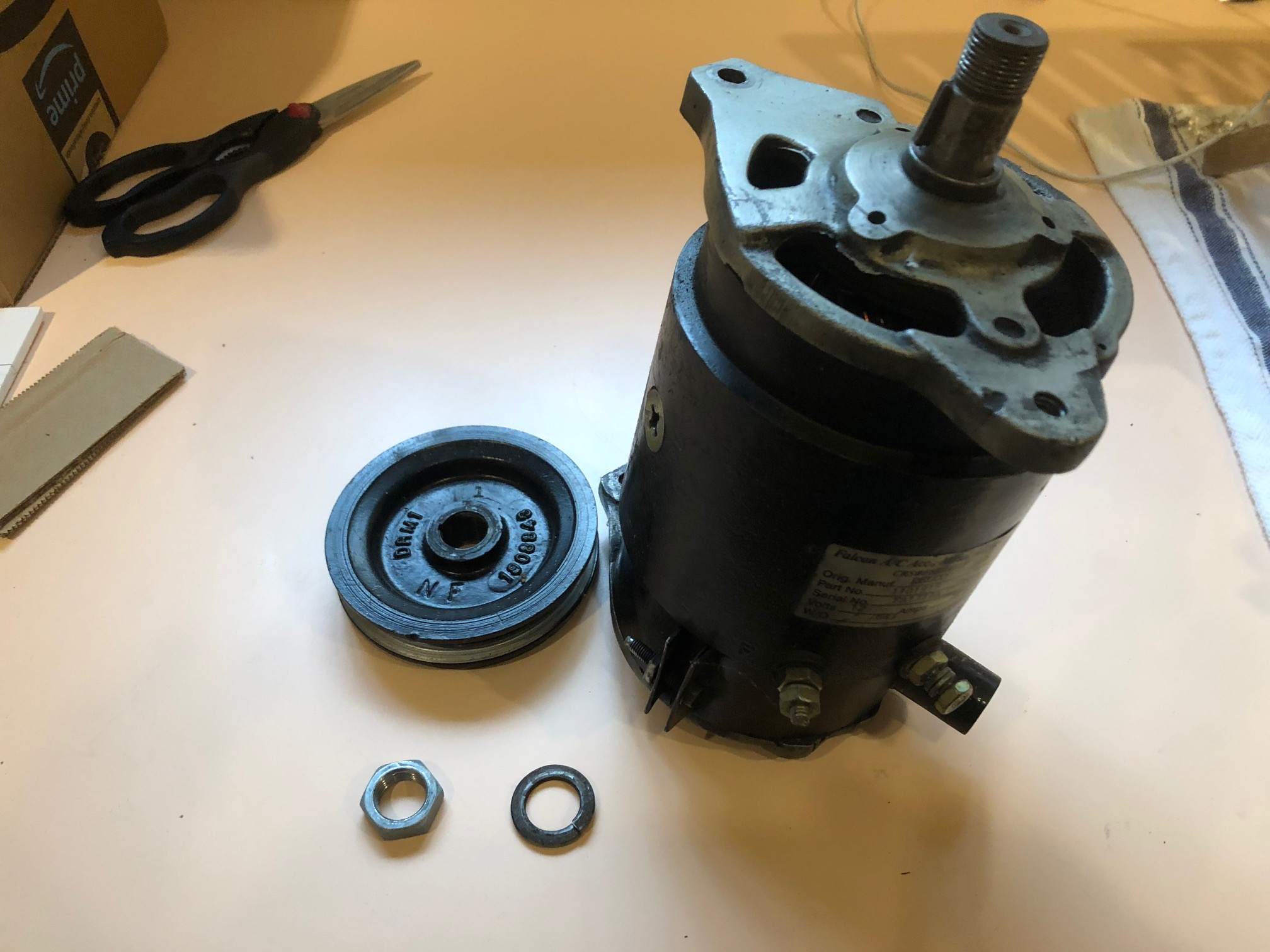

Shadrach Posted October 25, 2018 Report Posted October 25, 2018 I just happened to have a core in my garage at home. I cannot for the life of me understand why the the generator would need to be disassembled to remove the pulley. There are 5 components involved in this task: generator, pulley, woodruff key, split lock washer and nut. I braced the pulley in a vice using wood to protect the pulley. I broke the nut loose with a breaker bar (likely unnecessary) and then tapped the shaft with a drift from the front. It was not a complicated undertaking. 1
J0nathan225 Posted October 25, 2018 Author Report Posted October 25, 2018 3 minutes ago, Shadrach said: I just happened to have a core in my garage at home. I cannot for the life of me understand why the the generator would need to be disassembled to remove the pulley. There are 5 components involved in this task: generator, pulley, woodruff key, split lock washer and nut. I braced the pulley in a vice using wood to protect the pulley. I broke the nut loose with a breaker bar (likely unnecessary) and then tapped the shaft with a drift from the front. It was not a complicated undertaking. I think I spoke to them, right after they had opened the box and not much thought had happened yet as to what to do. They have figured it out, there biggest concern was the language on the return/void paper work and what if anything they could do. All is well and I should still be able to pick it up Saturday. 2
