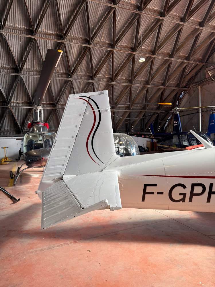

unicom Posted November 8 Author Report Posted November 8 (edited) 3 hours ago, Bartman said: I would also be aware of potential incorrect rigging of the trim system and know how to test it during preflight to ensure travel to the stops in both directions and confirm the indicator is working properly too. That’s something that really surprised me and which needs clarification. Although the tail was not in the correct position after the installation of the GFC500, I could still reach both the full-up and full-down trim positions. How is this technically possible ? Don't the upper and lower stops correspond to physical stops ? In other words, if the tail is already pitched nose-down even when the trim is in the neutral position, does that mean that when I move the trim to full down, the tail could go even lower than it normally should when properly rigged ? This is the picture of the tail with the trim in the take off band (before proper rigging). Edited November 8 by unicom
PT20J Posted November 8 Report Posted November 8 3 hours ago, unicom said: That’s something that really surprised me and which needs clarification. Although the tail was not in the correct position after the installation of the GFC500, I could still reach both the full-up and full-down trim positions. How is this technically possible ? Don't the upper and lower stops correspond to physical stops ? In other words, if the tail is already pitched nose-down even when the trim is in the neutral position, does that mean that when I move the trim to full down, the tail could go even lower than it normally should when properly rigged ? This is the picture of the tail with the trim in the take off band (before proper rigging). The front trim gearbox where the trim wheel is attached drives a leadscrew that turns the torque tube that runs to the jackscrew in the tail. This leadscrew has the up and down limit stops attached to it and the trim indicator is driven by a Bowden cable that attaches to a nut located on the leadscrew between the stops. Thus, the trim indicator indicates the position of the nut between the two stops. It is possible to adjust the cable length to the indicator at this nut. If the trim torque tube is disconnected from the aft jackscrew and rotated before reconnecting, the stops and trim indicator will no longer agree with the correct incidence of the tail. If things are way out of whack, I suppose the tail itself would impose limits on trim movement since the hinge at the bottom can only extend so far and the jackscrew itself will have limits of fore/aft movement. The picture appears to show nearly full nose down trim and I'm surprised that if this did indeed correspond to a takeoff trim setting that that there would be enough movement left in the system to move the trim to both stops, but I'm not doubting you since I've never tried it. 1

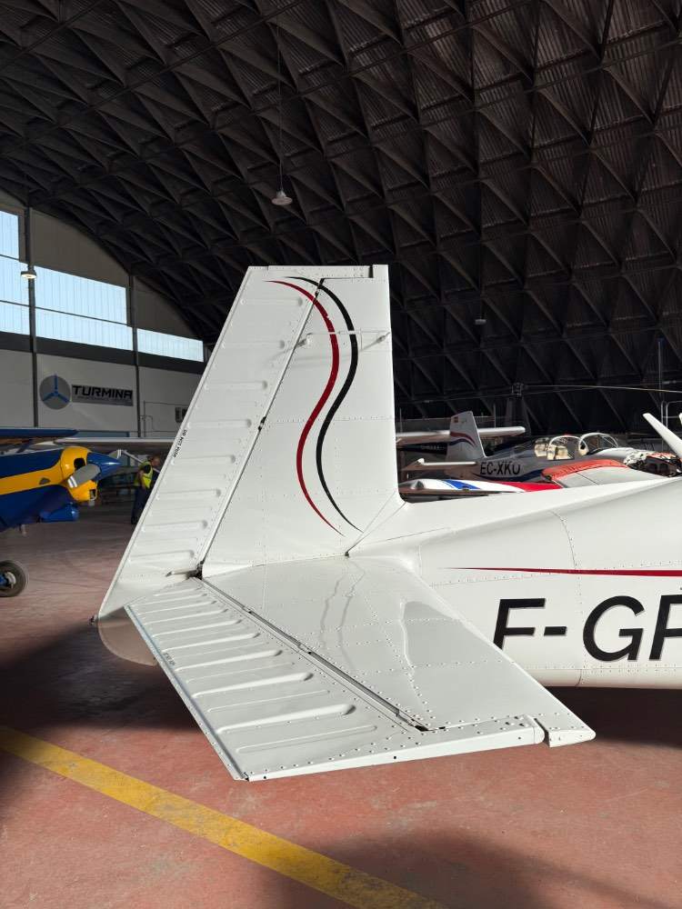

Bartman Posted November 8 Report Posted November 8 @unicom I am traveling, have not read that section of the manual in several years, and cannot answer your question. I am sure one of our more knowledgeable members can answer. I can say that my 1977 tail looks like the second picture posted by @DC_Brasil Mine does not look like yours with the indicator in the takeoff position When we rebuilt my jack screw I had that section of the manual marked, opened, and ready for the IA to discuss. We also made 3 reference marks on the tail feathers with magic marker on a piece of tape. One full up, one full down, and one at my normal takeoff position. Everything lined up after repairs, the indicator was in the right position, and I had confidence that it was done right. 1
unicom Posted November 8 Author Report Posted November 8 7 minutes ago, Bartman said: Mine does not look like yours with the indicator in the takeoff position And that is a good thing, because this is precisely why the tail of my aircraft needs urgently to be re-rigged !
unicom Posted November 8 Author Report Posted November 8 16 minutes ago, PT20J said: The picture appears to show nearly full nose down trim and I'm surprised that if this did indeed correspond to a takeoff trim setting that that there would be enough movement left in the system to move the trim to both stops, but I'm not doubting you since I've never tried it If the mechanic hasn’t made the adjustments yet, I’ll try to take some more photos with the tail in full trim down and full trim up positions. It’ll be interesting to see the difference.
PT20J Posted November 8 Report Posted November 8 18 minutes ago, unicom said: If the mechanic hasn’t made the adjustments yet, I’ll try to take some more photos with the tail in full trim down and full trim up positions. It’ll be interesting to see the difference. That would indeed be interesting. Just for comparison, I made some measurements at the tail of my 1994 M20J some time ago: With takeoff trim, the elevator is aligned with the stabilizer. With full down trim, the elevator is deflected down ten degrees and the fin rotates back 4 deg measured at the leading edge With full up trim, the elevator is deflected up ten degrees and the fin rotates forward 2 deg measured at the leading edge The gap between the tailcone and the empennage measured at the bottom below the hinge is: 4.5" - takeoff trim 3.5" - full down trim 5.25" - Full up trim 4

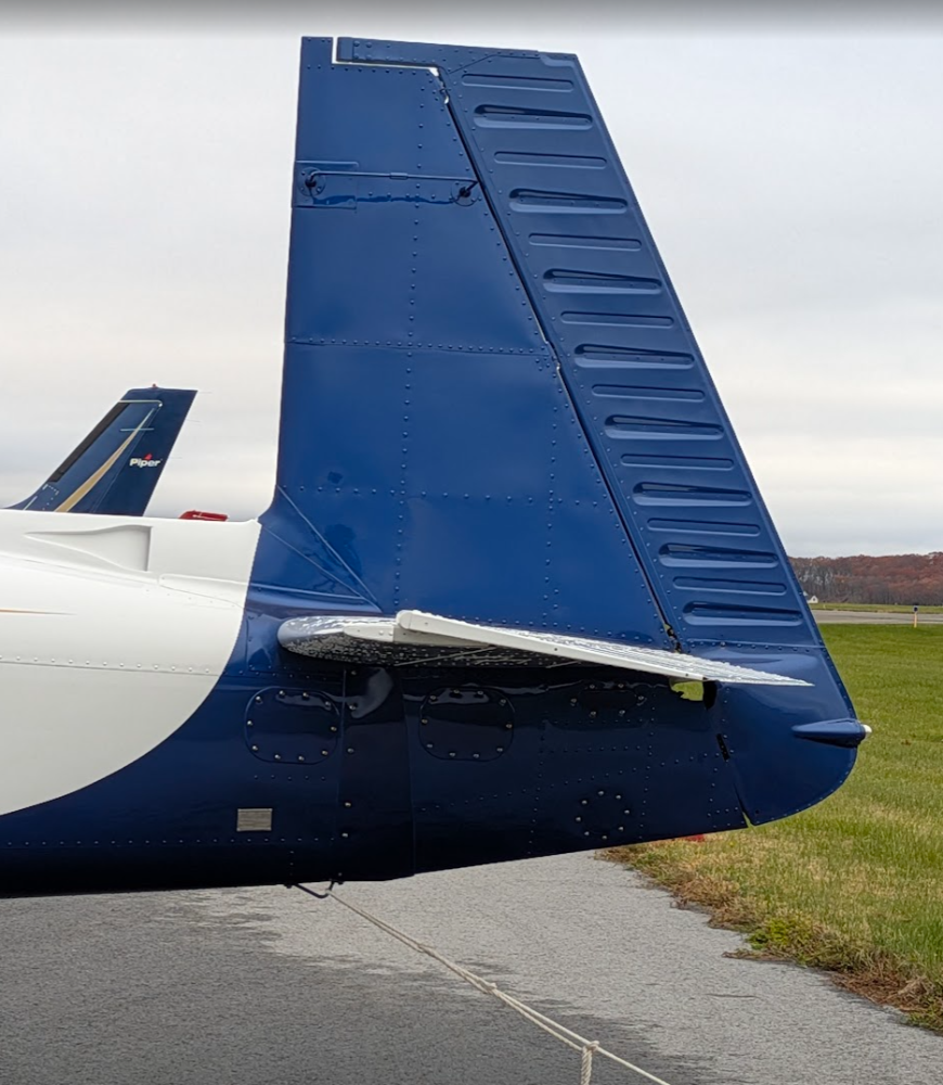

Flyler Posted November 15 Report Posted November 15 @unicom thanks for making this post. I saw your picture and thought "mine looks sort of like that, I wonder if it is out of rig" and brought it to the attention of my local A&P. He's sort of a wizard. Anyhow, my plane has electric trim and we figured it had been disconnected and moved at some point too. Rob worked his magic and gave me a good lesson on Mooney tail sections. We took the plane for a flight, and ended up doing 8 landings as it just felt sooo much better! Much more docile and predictable. Setting trim to take off position makes a whole lot more sense now. Before: This isn't the true "after" picture but is about what it looks like now: The elevator doesn't always end up in the exact same spot, so these pictures are far from precise. You can tell just by putting a bit of pressure on the yoke- it has some "stiction" so it'll stay put in a small range. Either way, it is reassuring that there's enough visual indication that *hopefully* pilots will notice this on preflight, if it is indeed off after having work done. 2

takair Posted November 15 Report Posted November 15 (edited) What is hard to see in Tyler’s picture is that the stab rigging was off by over 2 degrees. He never had full up trim which was actually closer to TO trim. Needless to say takeoff trim was very heavy and it was very difficult to get enough trim to land consistently. The elevator position varies depending on the vintage of Mooney. Older ones have only the bungee springs that yield a more upward position in takeoff. This J has a down bias spring, on top of the bungee springs, that provides constant down pressure. Full rigging requires removal of that spring and then reinstallation. Later models removed the bungee and have other mechanisms including bob weights. It is super critical that shops understand the mechanism. Just putting index marks on the torque tube when taking it apart to do work on the trim servo or tail is not good enough. The trim stops and trim indication are in front of the plane. As shown in this thread, it can be miss indexed to a hazardous level. Any post flights should be treated with caution. I wish the FAA still had the old service difficulty system that most mechanics read. They still have it, but it is not highly visible like it used to be. Thanks again for the kind words Tyler, but it is your integration into the entire ownership process that resulted in finding this. I feel the previous owner suffered through a poorly rigged airplane. Edited November 15 by takair Clarification on bungee springs 6 1

unicom Posted Tuesday at 08:59 PM Author Report Posted Tuesday at 08:59 PM The trim-rigging issue was eventually resolved by my local mechanic, who measured a 4.5-degree off-trim condition. This is significant, because on landing with two people on board the trim was fully at the trim-up stop, and during takeoff it was obviously far outside the takeoff trim band. I therefore want to highlight the importance of checking the correct trim rigging whenever work is performed on the system, especially when installing a GFC 500 autopilot, as was the case for my aircraft. Following this incident, I completed an occurrence report form — for whatever it’s worth, at least the Spanish authority has been informed. Improperly rigged rigging (trim indication in the take-off band): After proper rigging: 6
