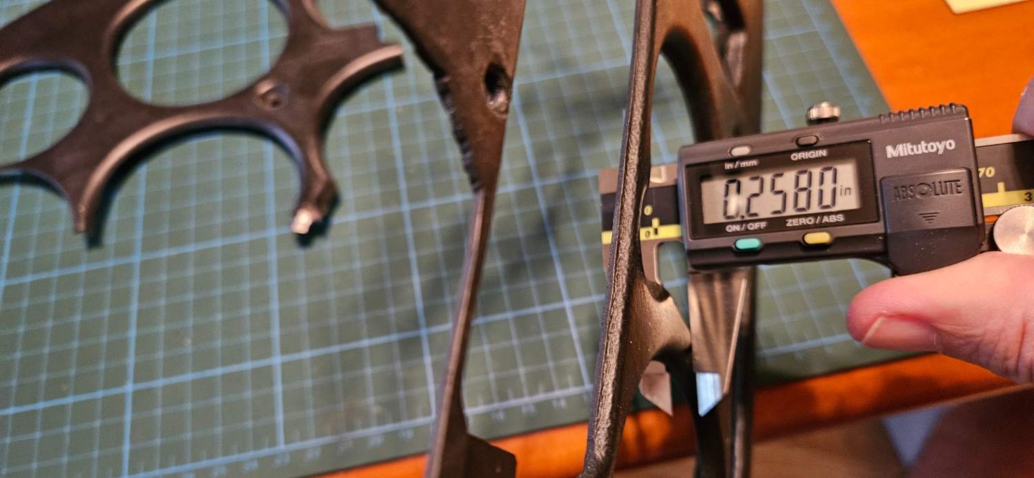

There is significant variation on my C. Up by the ASI is much less than over by the VORs. Not sure if it's a top-to-bottom thing, a left-to-right thing, or maybe some of both.
Then there's the taper on the right-hand edge . . . I measured a random spot in the middle.

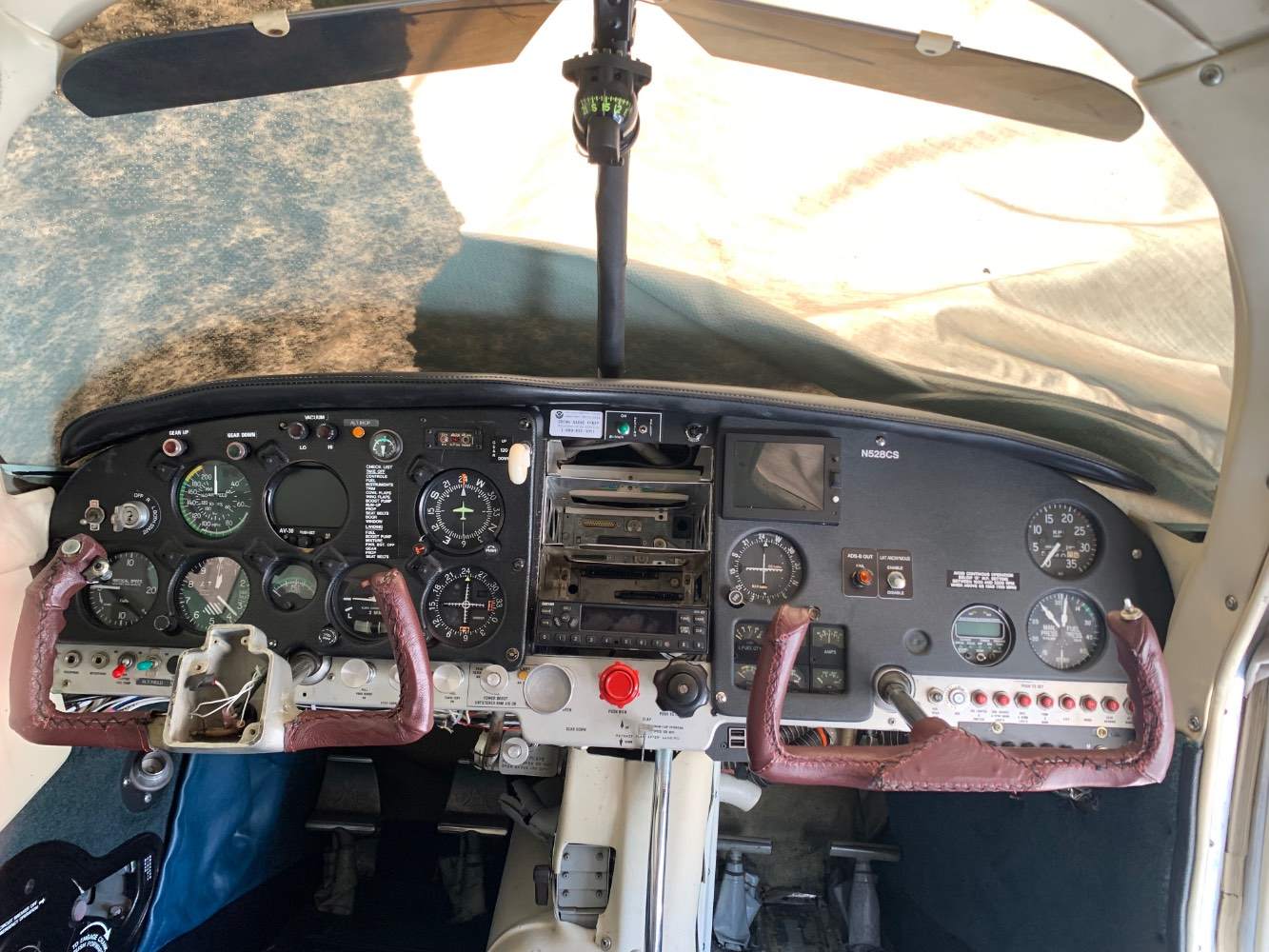

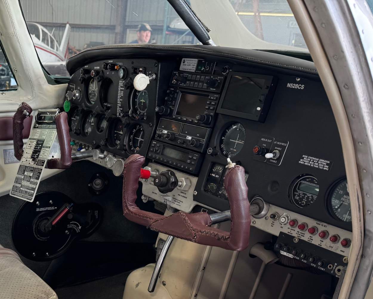

I reduced the thickness of the entire panel.  Can't tell you how much.  Season to taste.  Some of the round holes I cut the flange completely off to fit around existing instrument light bezels.  I used a larger hole saw with a wooden puck as a guide that fit the existing hole to keep the hole saw centered.  Here's a couple of pics.  Each hole tailored as required.  Need to make sure you have plenty of clearance where needed.  I went a little oversized on some instruments like the AI, DG and clock to make sure there's plenty of clearance around the buttons, knobs and shafts.  If I were doing it again, I’d reduce the thickness even more.  You can see the gap around the clock in the angled photo.
