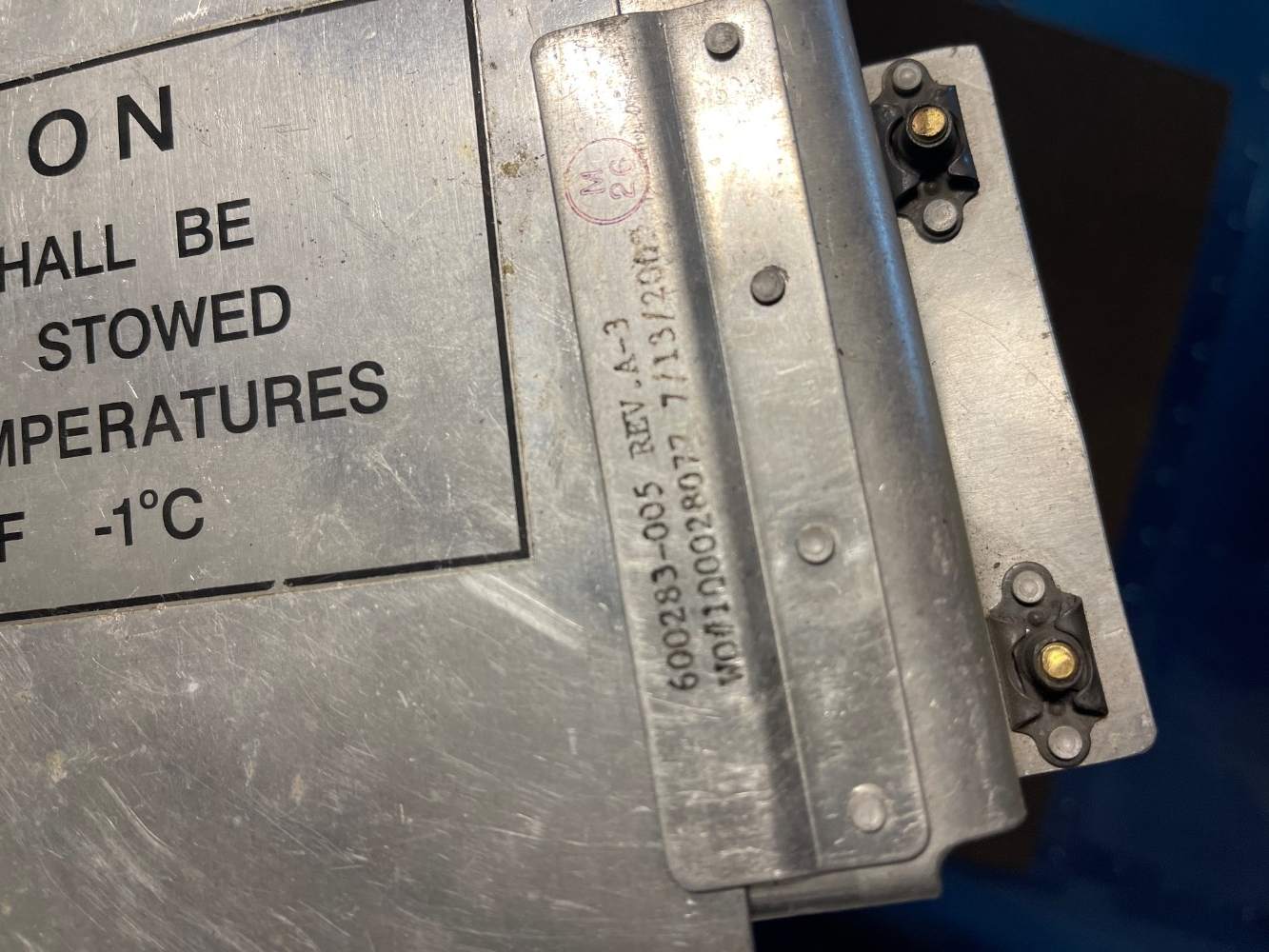

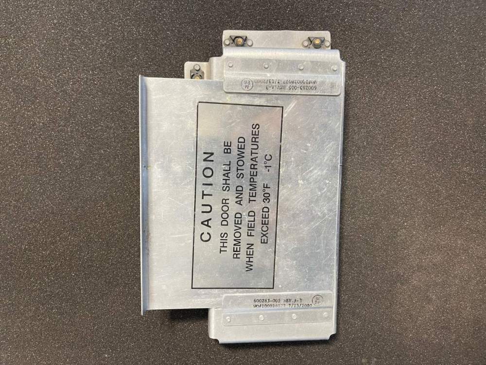

LANCECASPER Posted February 17, 2022 Report Posted February 17, 2022 45 minutes ago, Little Dipper said: Question for the engine guru's. Unless I am in a hurry I've been operating my new 310 hp IO-55O lean of peak. When I am flying LOP in cold air I can't keep my cylinder temps above 225 or my oil temperature above 150. If I run ROP my temps return to normal. My question is does it do long term harm the engine to run it LOP when the engine operating temp are that cool? Norm N995K There is a cold temperature kit that Mooney makes to slide over and partially block the oil cooler on Ovations to keep the temps up in cold weather. 3 Quote
Shadrach Posted February 17, 2022 Report Posted February 17, 2022 Need more info. “Running LOP” is not a lot of information to go on. What power setting? How far LOP? I run LOP almost exclusively this time of year because the dense air makes for near SL power into the cruise altitudes (I often see DAs of -3000ft or lower at my 700ft field). However, LOP means 5° to 15° not 50°. I use CHT as proxy for cylinder pressure but he noumber must change with OAT. A power setting that yields a CHT of 370° in August (acceptable detonation margin) is much different than the power setting that yields a CHT of 370° in February (quite a bit less detonation margin). Your problem is at the other end of the spectrum and it may be that you’re running way more conservative than necessary. Is it a problem, likely not in the short term. Longer term you may have problems with lead scavenging (fouled plugs) and high moisture content in the oil. The latter can be solved with the cold weather kit Lance mentions above. I use the cheap and cheerful method of blocking the oil cooler with aluminum tape. Not necessarily because I am cheap (guilty) but because of the 40° swings in OAT. It’s not unusual to see 60° and 14° in the same week during daylight hours. I like having the option to block, partially bock or completely block the oil cooler in just a few seconds. I adjust cooler winterizing to facilitate cruise oil temps between 185 and 210°. Quote
StevenL757 Posted February 17, 2022 Report Posted February 17, 2022 3 hours ago, Little Dipper said: Question for the engine guru's. Unless I am in a hurry I've been operating my new 310 hp IO-55O lean of peak. When I am flying LOP in cold air I can't keep my cylinder temps above 225 or my oil temperature above 150. If I run ROP my temps return to normal. My question is does it do long term harm the engine to run it LOP when the engine operating temp are that cool? Norm N995K Norm, the kit that Lance @LANCECASPER shows above is a necessity for us in the NE, so not sure if you have this already installed on the front of your oil cooler. Agree with Ross, in that we'd need to know your MP, RPM, and what altitude(s) and temperatures in which you're operating to give better feedback. Steve Quote

Little Dipper Posted February 18, 2022 Author Report Posted February 18, 2022 9 hours ago, LANCECASPER said: There is a cold temperature kit that Mooney makes to slide over and partially block the oil cooler on Ovations to keep the temps up in cold weather. I have the cold weather kit. Thanks. Quote
