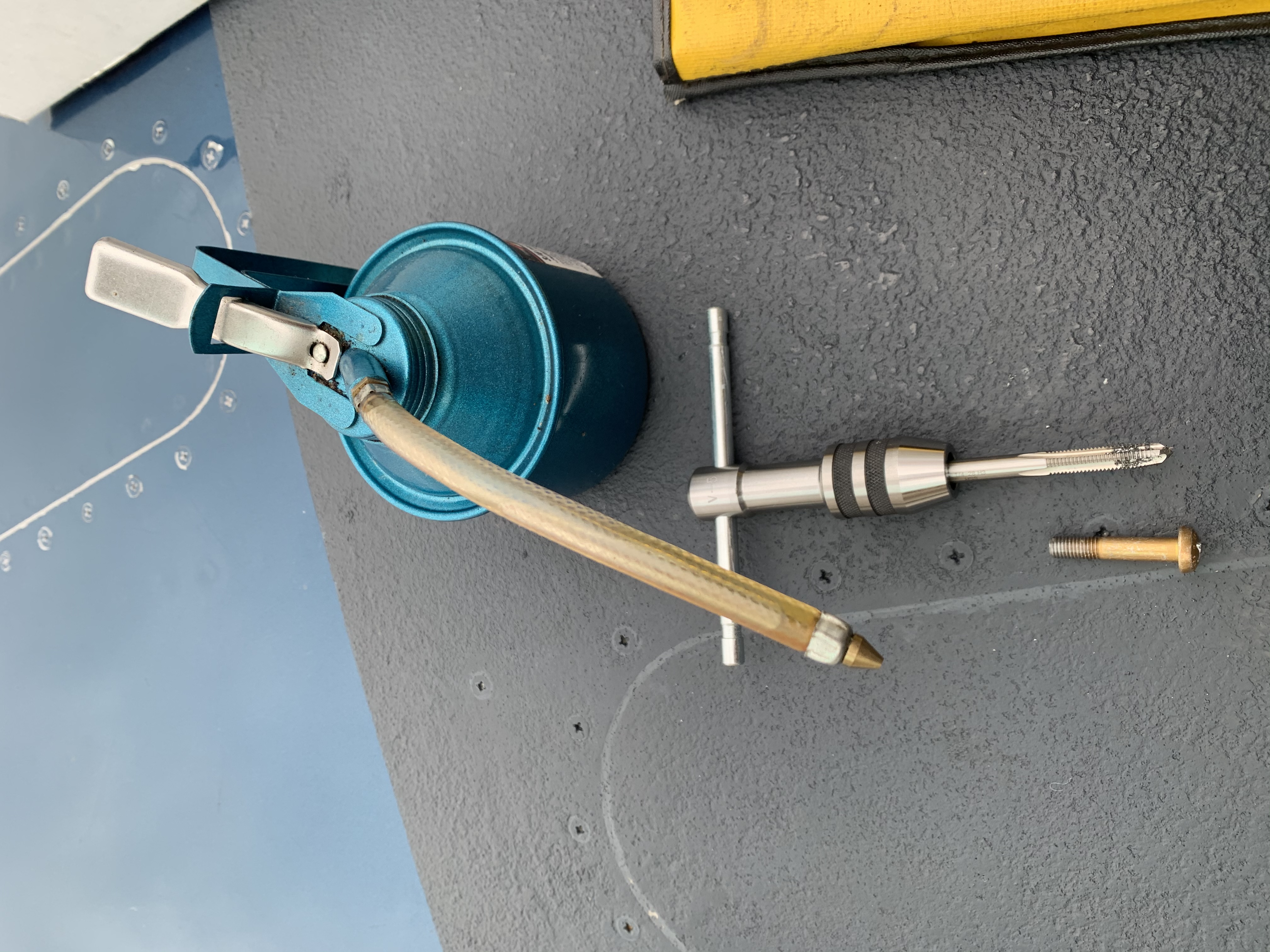

Derrickearly Posted September 7, 2020 Report Posted September 7, 2020 Just attempted to install my new rosen visors into my m20f. The pilot side went in easily. Unfortunately, the ms27039-4-18 screw will not engage on the passenger side. Any advice would be greatly appreciated. I just ordered some 1/4-28 taps and fresh screws from aircraft spruce. Quote

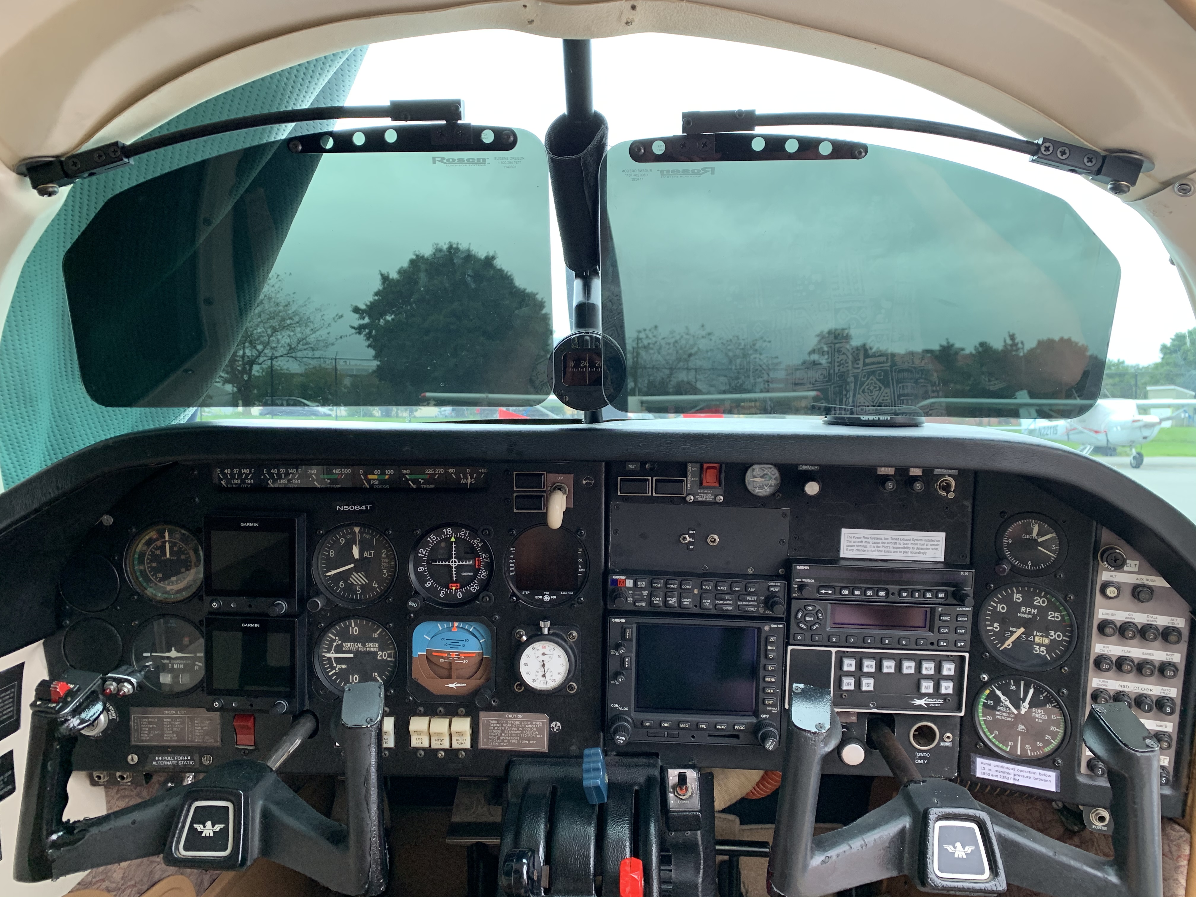

Derrickearly Posted September 9, 2020 Author Report Posted September 9, 2020 Here is the link to Rosen. https://www.rosenvisor.com/store/p106/Mooney.html I ordered the visors from Performance Aero. http://www.performanceaero.com/ The stc covers M20A through M20S. Quote

Derrickearly Posted September 12, 2020 Author Report Posted September 12, 2020 (edited) Finished the installation. Added large washers to prevent the arms from catching on the trim. Rosen provided a replacement screw. Cleared the threads with a tapered rap. Edited September 12, 2020 by Derrickearly 2 1 Quote
