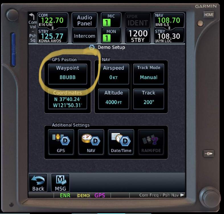

Bob - S50 Posted May 24, 2020 Report Posted May 24, 2020 2 hours ago, rotorman said: I am using my windows 10 for the Garmin trainer. Everytime I start it it puts me at KSLE as a starting point. I can't find any way to change it. So I have been flying it to where I want to train at 500 kts wasting a lot of time. Is there away to initialize it to a particular airport? When you start, and I think whenever you go to the Home page, you'll see a Demo button (if I remember right). Touch that and I think there is a Nav? button that allows you to set the starting location (haven't done that in awhile). You can also change the rate of climb/descent. I know it's there, I just can't remember where. 1 1 Quote

donkaye, MCFI Posted May 24, 2020 Author Report Posted May 24, 2020 10 minutes ago, Bob - S50 said: When you start, and I think whenever you go to the Home page, you'll see a Demo button (if I remember right). Touch that and I think there is a Nav? button that allows you to set the starting location (haven't done that in awhile). You can also change the rate of climb/descent. I know it's there, I just can't remember where. From the Home Page tap the Demo icon and change Waypoint to the airport of your choice. 1 Quote
StevenL757 Posted May 25, 2020 Report Posted May 25, 2020 1 hour ago, Bob - S50 said: When you start, and I think whenever you go to the Home page, you'll see a Demo button (if I remember right). Touch that and I think there is a Nav? button that allows you to set the starting location (haven't done that in awhile). You can also change the rate of climb/descent. I know it's there, I just can't remember where. Thanks Bob...had the same issue as @rotorman so I’ll try that. Quote
rotorman Posted May 25, 2020 Report Posted May 25, 2020 48 minutes ago, donkaye said: From the Home Page tap the Demo icon and change Waypoint to the airport of your choice. 1 hour ago, Bob - S50 said: When you start, and I think whenever you go to the Home page, you'll see a Demo button (if I remember right). Touch that and I think there is a Nav? button that allows you to set the starting location (haven't done that in awhile). You can also change the rate of climb/descent. I know it's there, I just can't remember where. Sheesh! These are the small trip-ups I am plagued with. Things that are perfectly obvious to some I don't see as if I were blind. Thanks for the tip. 1 Quote
midlifeflyer Posted May 25, 2020 Report Posted May 25, 2020 10 hours ago, rotorman said: Sheesh! These are the small trip-ups I am plagued with. Things that are perfectly obvious to some I don't see as if I were blind. Thanks for the tip. On the theory that a picture is worth a thousand words... 1 Quote
eman1200 Posted May 25, 2020 Report Posted May 25, 2020 I am using my windows 10 for the Garmin trainer. Everytime I start it it puts me at KSLE as a starting point. I can't find any way to change it. So I have been flying it to where I want to train at 500 kts wasting a lot of time. Is there away to initialize it to a particular airport? Another way (since you may not always want to start from the same airport) is to just scroll to where u want to start from and hit the ‘set’ button. I use this a lot when I want to check out an approach. Say I’m flying point a to b which is 300 miles. I’m not gonna sit there while it flies the entire route, or speed up the plane.....I’ll just scroll along the route until I get towards the end and hit set. Boom, the plane jumps to that location. 2 Quote
