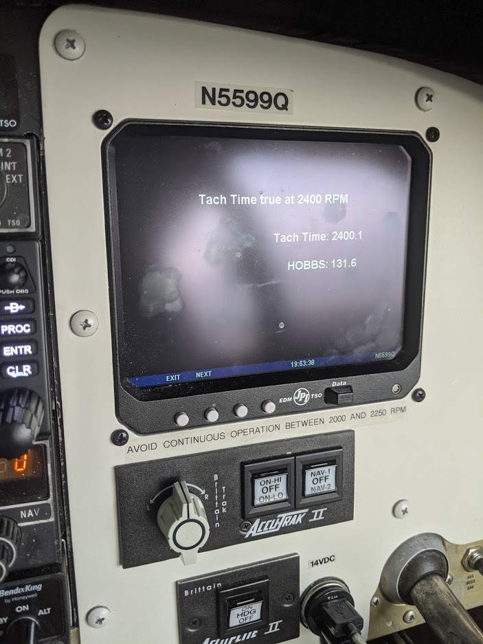

cferr59 Posted December 22, 2019 Author Report Share Posted December 22, 2019 Here are the control panels. I primarily tested with the Accuflite II ON attempting to use the heading bug and the others in OFF, but I did attempt a few other settings with similar results. I'm planning on flying tomorrow and can try to get a few more detailed test profiles. Quote Link to comment Share on other sites More sharing options...
takair Posted December 22, 2019 Report Share Posted December 22, 2019 To use the Accutrak you should also select the hi or lo with the nav switch. So both switches should be on. The accuflite should turn on the heading. I typically have the three switches on and the gain in high to track the GpS. No wandering when set up right. I recently had the o ring in the yoke disable switch leak, and it wandered a lot. If it worked on the demo flight and not now, it may be as simple as that. The button can be removed from the yoke. Some folks do that to disable the pC. I stopped doing that because it is what caused the problem I describe. Start the testing while the airplane is already on a radial. VOr centered and heading bug aligned. Should be steady. Also, do you have a GPS? There may be a switch to select between nav aids. Quote Link to comment Share on other sites More sharing options...

cferr59 Posted December 22, 2019 Author Report Share Posted December 22, 2019 Ok, I did a bit of testing today. I think my issue yesterday stemmed from attempting to use the Accuflite without turning on the AccuTrak. If you do that, it will not correct until it hit 30 degrees on either side of the heading. I need to take a longer cross country with it to confirm that it is 100% fine, but it turns out that this might just have been user error... 1 Quote Link to comment Share on other sites More sharing options...
