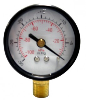

Mooneymite Posted November 2, 2018 Report Posted November 2, 2018 Can you T something like this in and just verify that you do/don't have vacuum? It's pretty cheap. VACUUM GAUGE (Click image for a larger view) Part # 01-14885 Quantity: $17.50/ea https://www.aircraftspruce.com/catalog/cmpages/vbvacuumgauge.php?clickkey=10146 Quote
