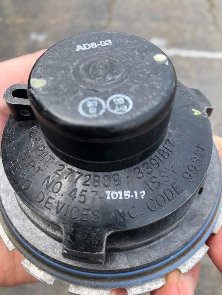

Some progress, finally took picture of the cap.  Looks like Shaw 457-1015-12? Do you happen to have cross reference?

Those fuel caps are "lighting proof" type fuel caps and generally can't be serviced. If you'll notice, it is already equipped with a fluorosilicone o-ring (blue o-ring with a lip). If it is working, do not mess with it. If the cap is broken, it will need replacement. PMA Products Inc. made an o-ring that is supposed to fit on that cap but I do not know what they are up to these days. Unfortunately I do not have kits for those type fuel caps. I tried and it did not work out.

Thanks for the response!  They seal well right now.  I had thought the orings deformed, did not realize it was special shape.  Couldn’t recall what they looked like new.
