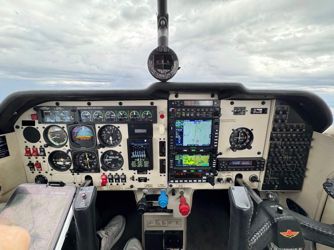

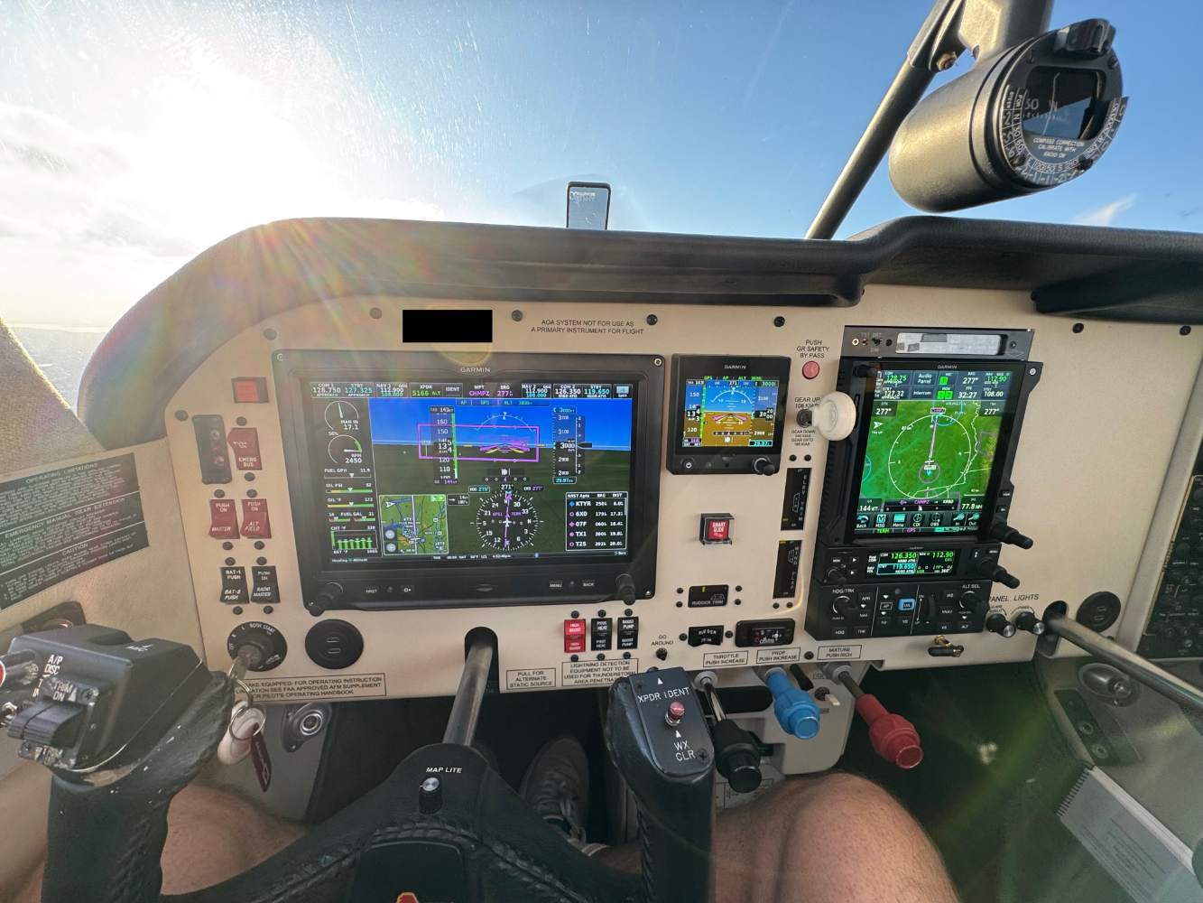

hammdo Posted January 16 Report Posted January 16 This is mine: AeroCruze 100 autopilot, G5s, GNC355, Insight G2 engine monitor, Garmin 327 transponder, BK 155 basic but very functional… -Don 3

Ragsf15e Posted January 16 Report Posted January 16 2 hours ago, jamesyql said: Excellent re: engine monitor. Audio panel can typically be replaced pretty easily so maybe separate the issues and do the audio panel to start if it is really limiting you. I think starting with AP for your avionics is the right move. If it is out of the budget right now, I would defer the upgrade and enjoy the plane as is. No sense of having an IFR capable plane and no autopilot to make it safe to fly IFR. Curious, is there anyone on here flying IFR regularly without an autopilot? Also- for US pilots. Don't you need WAAS with ADSB to fly in a majority of busier airspace? I have it, so haven't considered this question when I fly to the states. Well not really, but yes, sort of. You do need WAAS with your ADSB, but many "cheaper" ADSB out solutions come with an integrated WAAS gps (such as uavonix tailbeacon https://www.aircraftspruce.com/catalog/avpages/uavionix_11-17246.php). Now if you go that route, you don't get WAAS for the IFR approach capability, but you are legal for ADSB. If you get a WAAS IFR gps and then use that to feed an ADSB out transponder, there's likely a lot more $$ involved. Does the airplane currently have ADSB out? If you go the G5 or GI275 route, you can do the autopilot later as those units would work with the GFC500.
