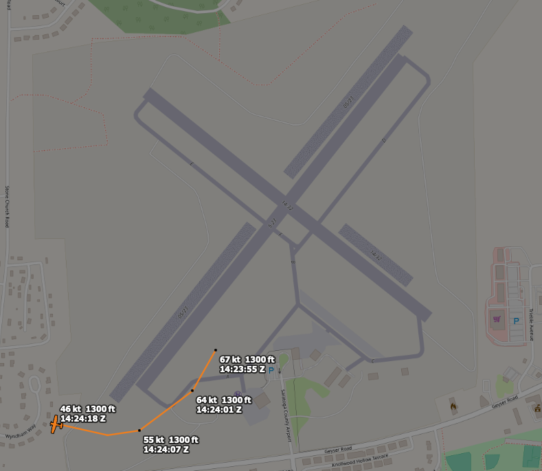

Is this the one you bought from the guy (Thomas Boardman) that bought it in 2024 (Conrad) who bought it out of annual and according to him "got a great price on this airplane)? :
https://www.flightaware.com/live/flight/N79338/history/20251009/1601Z/5B2/5B2
When it was for sale in 2024 the Seller said, "Whoever gets it next needs to be ready for the cost of an overhaul, but I hope they also feel like the price I'm offering is a good deal that can be the start of a great relationship for someone who wants to spend their time and money taking care of this amazing old plane." Most people buy an airplane to fly, not as a project, which is what he was hinting that this one was.
Why did the Seller sell the plane right after purchasing it?  Same issue and didn't tell it to you?  I wouldn't consider flying in that plane until I had a definite reason for the engine failure.  What kind of confidence in the plane can anyone have in such a circumstance?  Suppose the engine had quit right after takeoff at 400 feet.  You had a lucky day.
