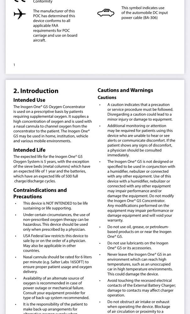

201Mooniac Posted June 23 Report Posted June 23 11 hours ago, Aaviationist said: A lot of times that is the advertised price with Medicare. Especially when it comes to medical devices, you can’t just google something and use the ads that come up as a price. The cheapest I can find that I would trust sending money to Majorcpap - where it is 2k. Even then, 14k limit for 2 people is a non starter. the Inogen has a service life of 5 years. Compared to the cost of a hydro test (150$ last I did it) it still doesn’t make sense to justify the Inogen. You are free to find a more expensive site you are comfortable with but I bought mine when Pure Medical has a special and paid less than $1500 for my setup with no medicare as I'm still too young for that (though not for long). There is nothing in the documentation that came with the unit that shows a 5 year service life, the only requirement is to replace the canister when the unit tells you it is exhausted. I've used mine many times and it always keeps my SpO2 well into the 90s. Much easier than the bottle I used to use. 2
Aaviationist Posted June 23 Report Posted June 23 1 hour ago, 201Mooniac said: You are free to find a more expensive site you are comfortable with but I bought mine when Pure Medical has a special and paid less than $1500 for my setup with no medicare as I'm still too young for that (though not for long). There is nothing in the documentation that came with the unit that shows a 5 year service life, the only requirement is to replace the canister when the unit tells you it is exhausted. I've used mine many times and it always keeps my SpO2 well into the 90s. Much easier than the bottle I used to use. Page 2. Page 1 is the glossary. are you guys really basing all these potentially life saving decisions based on things you’ve read on the internet and not having any idea what the manual and manufacturer guidance is? talk about some bad ADM….

Pinecone Posted June 23 Report Posted June 23 19 hours ago, Aaviationist said: Not sure about the federal reg side, but for Inogen, they definitely don’t want you doing what Will is doing. No reg sets any requirement other than you must use some form of supplemental O2. The 5 year life on the columns is based on 24/7 use. If you fly 168 hours a year using it, that is 1 week of medical use. So that 5 year life is MANY aircraft years. Most of use using the units wear a pulse oximeter to continuously monitor our O2 saturation level. 2
