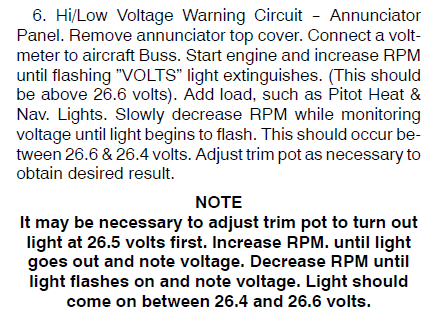

I noticed my voltage drops at quite high RPM and one alternator ALT VOLTs light stays on longer than the other at idle power.
Is this normal:

@hazek I can't tell you what RPM it should drop off, but according to the service manual if appropriately set it should extinguish at 26.5 V.  (This is from service manual for a M20K, but the annunciators are all IAI and the logic should be similar).

In mine, the Left ALT light comes on around 850, goes off around 1000. Right side doesn’t seem to care what the RPM is.

The answer to my thread question is: Depends on the setting!
From the MM:
