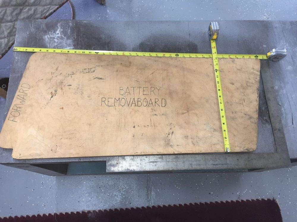

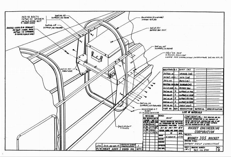

IvanP Posted May 5, 2025 Report Posted May 5, 2025 20 hours ago, N201MKTurbo said: The mod would physically and structurally accommodate that much. I think they ended up with about 25 Lbs. It wasn’t my deal, I was just an observer and when it was done they threw me the keys and said to go check it out. It flew much nicer with the weights. Was this weight added after the batteries were relocated to the tail section? I flew a Rocket that had both bateries far aft in the tail couple of times and it felt a bit nose heavy with just one person in it, but overall a nice flying machine. I do not think that teh owner added any more weight after relocating the batteries. Accessing the batteries was a different story .
N201MKTurbo Posted May 5, 2025 Report Posted May 5, 2025 Yes, it had the dual battery box aft of the access panel. 1

1980Mooney Posted May 5, 2025 Report Posted May 5, 2025 (edited) On 3/24/2025 at 5:45 PM, N201MKTurbo said: FWIW, a friend of mine got a field approval for adding as much as 110 pounds of Charlie weights to the tail of a Rocket. The FAA man said he would approve the mod for any Mooney. He made real drawings and had them approved by a DER. 22 hours ago, N201MKTurbo said: The mod would physically and structurally accommodate that much. I think they ended up with about 25 Lbs. It wasn’t my deal, I was just an observer and when it was done they threw me the keys and said to go check it out. It flew much nicer with the weights. 23 hours ago, goodyFAB said: im not arguing but as a rocket owner i can tell you that 100lbs on the horizontal will put the tail toward the ground. On 3/24/2025 at 9:27 PM, Aerodon said: It takes less than 110 lbs on the elevator to put the tailskid on the ground.... 1 hour ago, IvanP said: Was this weight added after the batteries were relocated to the tail section? I flew a Rocket that had both bateries far aft in the tail couple of times and it felt a bit nose heavy with just one person in it, but overall a nice flying machine. I do not think that teh owner added any more weight after relocating the batteries. Accessing the batteries was a different story . In round numbers the Missile 300 added about 200 lbs on the nose gear of the mid body J (full feathering prop, 2 extra cylinders hung farther forward). I am not sure how much the Rocket 305 added ( heavier case, cylinders and added intercooler and full featheirng prop.) but likely substantial. But don't forget that the Missile 300 and Rocket 305 conversion put 2 batteries in a battery box as far back in the mid body tail cone as it could go as @N201MKTurbo highlighted. That weighs over 60 lbs. (one approx 30 lb battery was removed from the baggage compartment wall). Also back then the conversion included a approx. 8 lb AeroSafe Guardian Standby Electric vacum pump located in the tail cone. The autopilots were pretty heavy, and control computer mounted in tail cone also. If a Rocket or Missile owner goes all electronic on the panel and go with a modern autopilot, although you take the vacum pump off the engine and a few pounds off the instrument panel, you can wind up removing a lot of weight much further back in the tail cone making the CG worse. And if a Rocket or Missile owner is stupid enough to go to EarthX batteries in the tail they will just have to add that much additional Charlie Weights. Edited May 5, 2025 by 1980Mooney
1980Mooney Posted May 5, 2025 Report Posted May 5, 2025 1 hour ago, IvanP said: Was this weight added after the batteries were relocated to the tail section? I flew a Rocket that had both bateries far aft in the tail couple of times and it felt a bit nose heavy with just one person in it, but overall a nice flying machine. I do not think that teh owner added any more weight after relocating the batteries. Accessing the batteries was a different story . Without the custom Battery Board on a Missile or Rocket, you are totally screwed. You will get a hernia and probably damage the tailcone.
