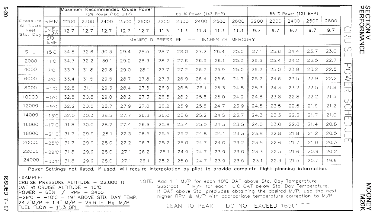

Marc_B Posted April 15, 2025 Report Posted April 15, 2025 6 hours ago, Ragsf15e said: ~50 rich of peak is even worse… yet isn’t that where the Encore power setting table in the poh has you? My POH for Encore shows 75% as maximum recommended cruise power and suggests you "LEAN TO PEAK, DO NOT EXCEED 1650 deg TIT."
Fly Boomer Posted April 15, 2025 Report Posted April 15, 2025 6 minutes ago, Marc_B said: My POH for Encore shows 75% as maximum recommended cruise power and suggests you "LEAN TO PEAK, DO NOT EXCEED 1650 deg TIT." I don't have an SB engine, but that sounds like bad advice. 2
DCarlton Posted April 15, 2025 Report Posted April 15, 2025 30 minutes ago, Marc_B said: The stoichiometric ratio of air:fuel (ideal ratio that burns all fuel and doesn't leave excess air) actually is a little rich of peak EGT. So at peak EGT you still have some "air left" that you can add more fuel to burn. But in terms of "harmful ways to run your engine," it's been described is the "Red Box" / "Red Fin". i.e. at high HP the area of the curve with potentially harmful ICPs (internal cylinder pressures) and temps goes from "a" degrees lean to "b" degrees rich. Given less fuel is being burned the lower %HP you run, the smaller that "danger area" red box width is, and below a certain %HP (some use 65%) you don't have enough fuel burning to be able to generate a "dangerous" ICP/temps and the "red box" disappears. But at higher and higher %HP, the box starts widening and widening. This is exactly why you run full rich on takeoff...if you ran peak EGT at 100%HP you'd most definitely have dangerous temps and ICPs and would have a very short flight into detonation. That makes 3! These pic are flipped from the way I usually have seen it with ROP to the right and LOP to the left, but gives you an idea of where things fall and rise. https://aviationsafetymagazine.com/features/lean-of-peak-egt/ I need to read the article. I struggle with the fact that we're dancing around values less than maybe 10 percent of peak to move from acceptable to dangerous operations. I can see any value that triggers detonation as a bad thing but you'd think the engine would be designed to operate within all the other ranges (because even visually the curves are pretty flat accept for EGT). There's something I'm missing.
Ragsf15e Posted April 15, 2025 Report Posted April 15, 2025 45 minutes ago, Marc_B said: My POH for Encore shows 75% as maximum recommended cruise power and suggests you "LEAN TO PEAK, DO NOT EXCEED 1650 deg TIT." Yeah you’re right, mine too… i know i saw that somewhere. Now im going to be looking everywhere! Either way, peak/1650 tit or 50 rop don’t seem very healthy to me!

Z W Posted April 16, 2025 Report Posted April 16, 2025 When we first got the plane, we followed the POH and ran 75% power (28" and 2500 RPM usually) and peak TIT as it suggests for a short time. No signs of detonation and I really don't think it's unsafe, but the TITs would be right near 1650, sometimes requiring adding mixture to stay under that, and the CHTs would be pushing 400 even with the cowl flaps mostly open. Most of the internet seems to believe those temperatures are not good for turbo and cylinder longevity. It seems to be the best setting for speed, fuel burn, and range, giving roughly 140 KIAS at 11.5 GPH, which may be why the marketing department at Mooney wanted it that way to sell more airplanes. Now I often run the same setting but add about 2 GPH, doing about the same speeds but TITs under 1600 and CHT's under 380. I know from experience this is far away from any setting that will cause detonation, the decreased CHTs are an indication that the internal cylinder pressures are well below peak conditions, and this should be a reasonable way to run the cylinders and turbo. Sometimes, depending on outside air temp and altitudes or some other factors I don't fully understand, I can lean down closer to 12.5 GPH while staying within these temperature limits, if I want a little more economy or range. The extra 2-ish GPH paid at the pump is hopefully a tradeoff for increased cylinder and turbo life, and the plane has so much range it's easy to just add enough fuel to plan 13.5 GPH block on just about every flight. If I need more economy, it's easy to just reduce MP a couple inches to 26 or so or remove 100 RPM to 2400 and get the fuel flow down around 10 GPH, and then run closer to peak TIT with a cool turbo and cylinders. But you do lose about 10 knots of speed. I detect roughness at all LOP power settings I've tried and so don't use them. It's slight but there. I've wondered sometimes if different pilots are more or less sensitive to that, and if I flew in someone else's plane who prefers LOP, if I would detect roughness they do not. I have not done the GAMI test nor installed GAMIs. I may do the test sometime for education's sake, but the plane is already so efficient it seems like a fair amount of hassle and cost for minimal gain.
