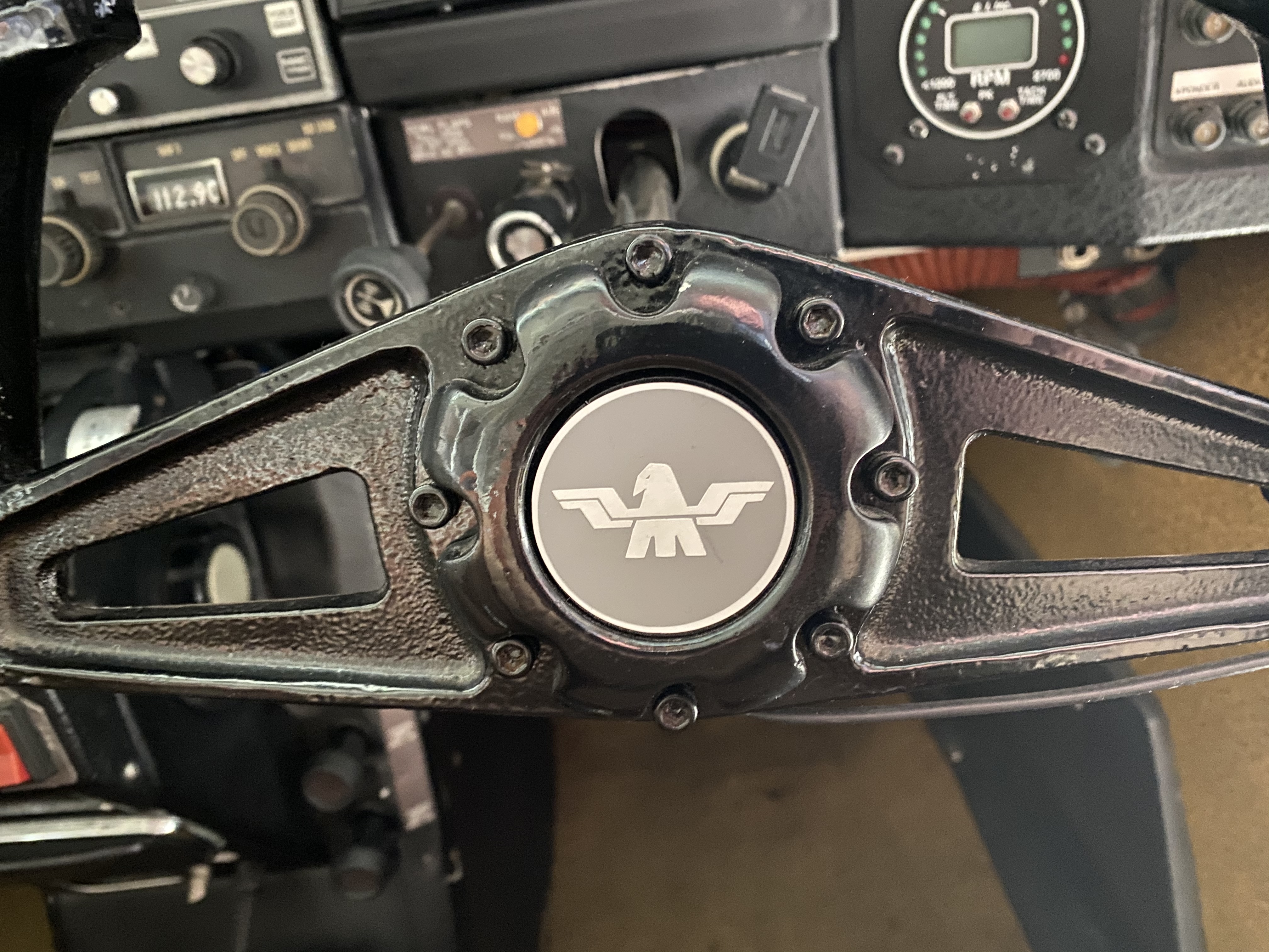

Zak Posted November 23, 2020 Report Posted November 23, 2020 Our yoke emblems were broke and missing. I made a cast of one to replace ours. They turned out great! Do does anyone need a replacement? You will have to drill the mounting holes and paint them. A friends wife cut the Mooney logo out in vinyl. 3 Quote
carusoam Posted November 23, 2020 Report Posted November 23, 2020 Zak, Are you flying a ‘74 M20F? Those look familiar to a few yokes around here like @Marauder’s... Interesting casting solution you have there..! Can you describe the impression and casting method you used? (Possibly dental technology? ) Best regards, -a- Quote
Zak Posted November 23, 2020 Author Report Posted November 23, 2020 I used a casting kit. Worked really well. I could see lots of possible applications for it. https://www.alumilite.com/resins/super-casting-kit/ 1 Quote
David Lloyd Posted November 23, 2020 Report Posted November 23, 2020 Zak, one of mine is loose on the control wheel. How is it held on? Yours turned out great. Love the mongo yokes. Quote
Zak Posted November 24, 2020 Author Report Posted November 24, 2020 Pop out the center circle disk, there are 2 screws that hold it to the yoke. You can put a dab of RTV behind the emblem if you can not tighten the screws. Don't get them too tight the plastic is brittle and breaks easily. The disk probably has RTV holding it in place also. Quote
