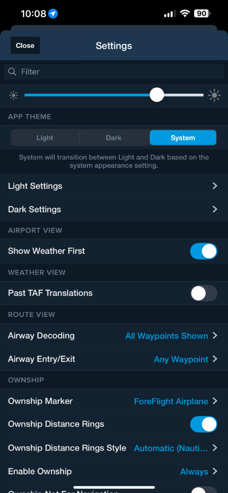

I just got a new iPhone 16.  The Foreflight image on the new phone looks cartoonish.  Is there a way to have it display like the iPad?
Try more, settings and use something other than system - FYI I don't have a 16 to verify…
Just to confirm since the phone is new...  Have all the DBs completed downloading on the phone?  You may be looking at Online maps and not from the DB on the phone.

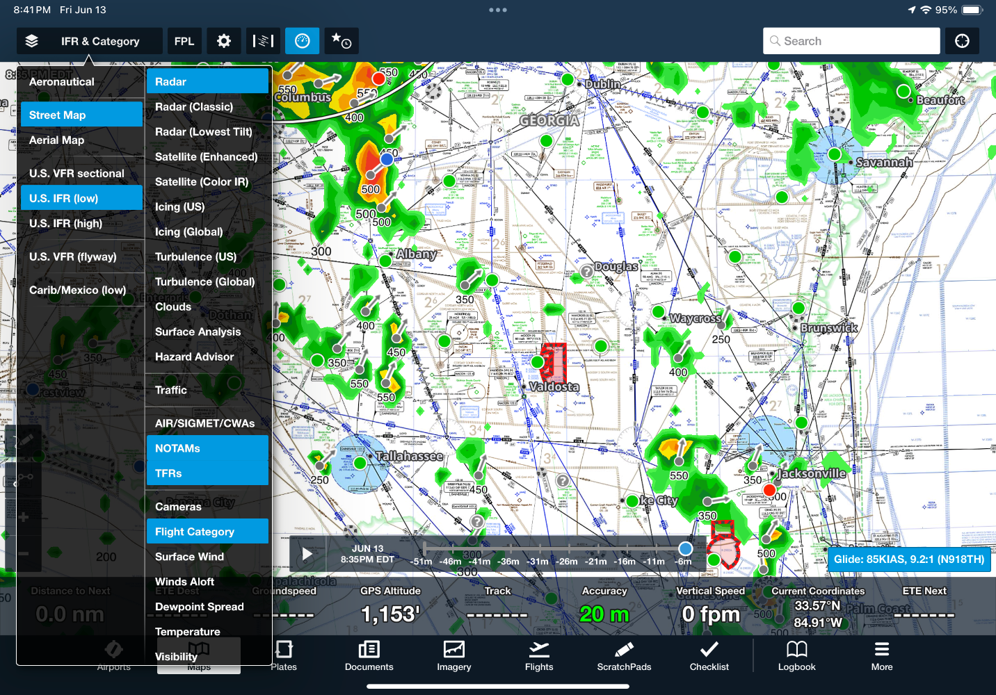

Can you elaborate on what this means? The iPhone image you posted has the Aeronautical map layer selected, the iPad image does not. If it's the airport and airspace symbols/lines you're talking about, deselect the Aeronautical map on the iPhone and they will be removed.

Yep. Too many things different from what is selected to display (including the aeronautical layer) to the zoom level. I'm not even sure what the complaint is.
My complaint is the pink outlines on the map.  However, Rick correctly said it’s the aeronautical map.  I don’t use that and don’t know how it got selected.  Anyway, it’s solved.
