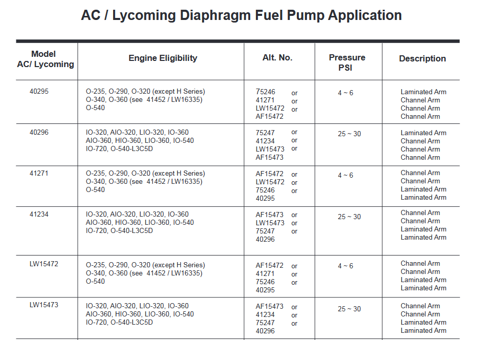

Vance Harral Posted April 27 Report Posted April 27 Finished a flight yesterday and observed fuel dripping from one of the hoses that exits the left side cowl flap (not from aux pump drain, that's further back). As the "streaming" blue stain on the nose gear door in the attached photo shows, there's evidence it dribbled in flight and streamed back along the gear door (there's a little oil there too, but that's normal for us). Haven't uncowled the engine yet, but I'm 99% sure from memory this is the hose that goes to the engine-driven fuel pump's overboard drain. As I understand it, this means the internal seals and/or diaphragm of the pump are failing, and it's time for a new or overhauled unit. My question to the hive mind is about part numbers. The application guide at https://www.aircraftspruce.com/catalog/pdf/TEMPEST-FP-APP-LYC.pdf has three options for the fuel pump in an IO-360-A1A, part numbers 41234, 40296, and LW15473. Researching these part numbers suggests variations involving "channel arm", "laminated arm" and "dual diaphragm". Anyone care to render opinions on why we should choose one part number over another? All three flavors appear to be readily available in new and overhauled forms. Some are more expensive than others. The cost difference isn't an issue for us, but I want to understand the pros and cons before engaging with our mechanic. Quote

Vance Harral Posted April 27 Author Report Posted April 27 Thanks very much for the pointer to that thread, @takair. It's regrettably disappointing in two respects. One, it doesn't seem to answer the questions of whether an LW15473 that produces over 30psi is actually mechanically problematic, vs. only legally problematic, and how/if one can ensure getting a unit that doesn't exceed the legal spec. Two, it documents that the cost of the pumps has nearly doubled in the last 3 years. Aside from pressure regulation, I'd still like to understand what's supposedly better about the LW15473 that justifies a higher price, given that the other flavors are readily available. Quote

Vance Harral Posted April 27 Author Report Posted April 27 5 hours ago, MikeOH said: only the LW15473 is shown in the Lycoming manual That's certainly a definitive reference, but the Tempest guide says thusly: Another Tempest document has this data, in which the 41234, 40269, and LW15473 are seem to be listed as alternates for each other, albeit with "Channel Arm" vs. "Laminated Arm", whatever that means. Quote
Vance Harral Posted April 28 Author Report Posted April 28 I think one difference may be that if you want new, the LW15473 seems to be the only option. The 40296 and 41234 are available only as overhauled. Quote

N201MKTurbo Posted April 28 Report Posted April 28 The pump in the video has the laminated arm, the U channel arm is pressed from a single piece of sheet steel. 1 Quote
