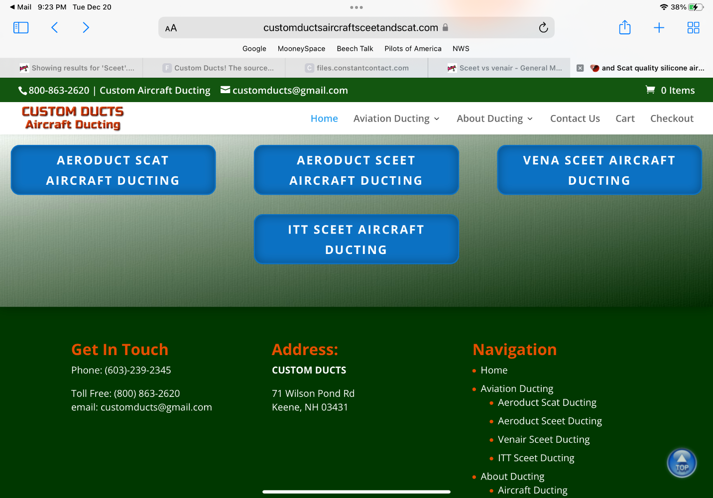

 I’ve never heard of venair but saw it on https://customductsaircraftsceetandscat.com/about-ducting/.
