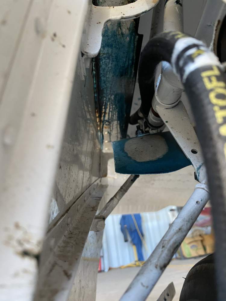

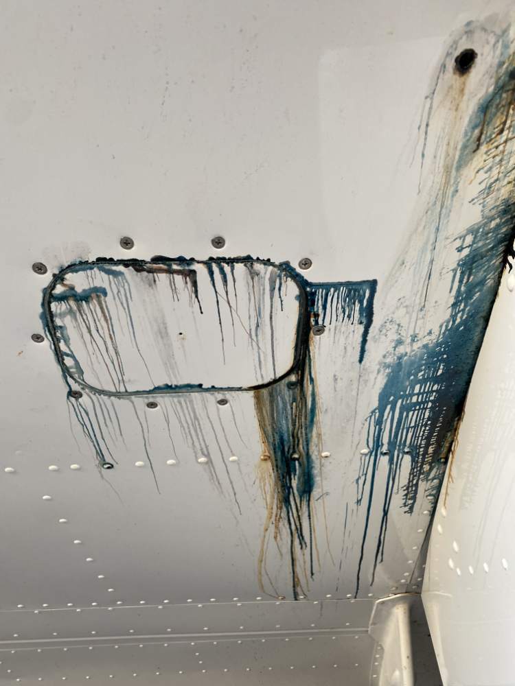

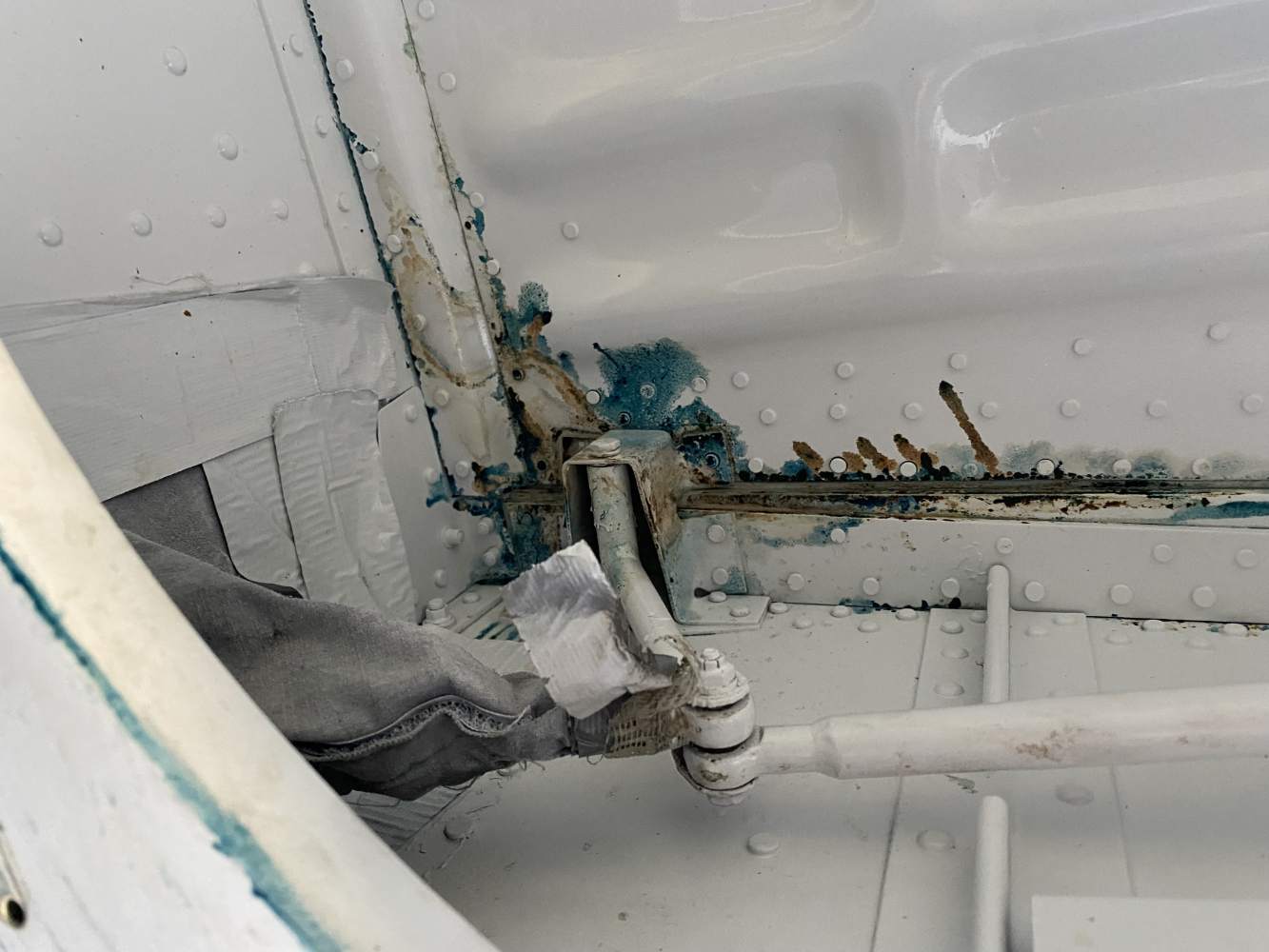

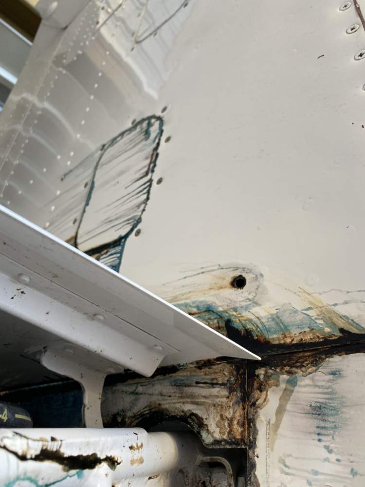

231LV Posted November 8 Report Posted November 8 (edited) Had my tanks completely resealed 18 years ago by Willmar. The right tank has developed a pretty severe leak staining the gear strut, the entire seam along the landing gear, the access panel. I tried patching at Chandler a year or so ago ...no joy. I am very very reluctant to fly back to Willmar, Florida or Texas to reseal the tank. Are there any other options I am unaware of? Edited November 11 by 231LV corrected timeline
LANCECASPER Posted November 8 Report Posted November 8 1 hour ago, 231LV said: Had my tanks completely resealed over ten years ago by Willmar. The right tank has developed a pretty severe leak staining the gear strut, the entire seam along the landing gear, the access panel. I tried patching at Chandler a year or so ago ...no joy. I am very very reluctant to fly back to Willmar, Florida or Texas to reseal the tank. Are there any other options I am unaware of? At least get Paul Beck from Weep No More in Willmar on the phone and send him some pictures. You might also put some pictures on here.
Ragsf15e Posted November 8 Report Posted November 8 14 minutes ago, 231LV said: Had my tanks completely resealed over ten years ago by Willmar. The right tank has developed a pretty severe leak staining the gear strut, the entire seam along the landing gear, the access panel. I tried patching at Chandler a year or so ago ...no joy. I am very very reluctant to fly back to Willmar, Florida or Texas to reseal the tank. Are there any other options I am unaware of? If you wanted to try another patch, Advanced in Troutdale Oregon is real good. Greg used to do full reseals but just does patching now, but he’s really good at fuel tanks and good to work with.

MooneyMitch Posted November 9 Report Posted November 9 2 hours ago, 231LV said: I suspect this is beyond a patch but I will give him a call and send pics Possibly the word "patch" implies a small area to be dealt with. Greg is excellent at patching beyond a small area. He's excellent! 1

N201MKTurbo Posted November 9 Report Posted November 9 Don’t think of it as a patch. There is nothing in the service manual about patching a tank. It is not approved anywhere. What is approved is resealing a portion of the tank. 4

Fritz1 Posted November 10 Report Posted November 10 As stated before, contact Paul beck at Weep No More, he sealed the tanks in the first place, his warranty is 7 years and he stands behind his work, he may be interested in understanding what happened here and why and he is one of the most competent people to fix the problem 2
Yetti Posted November 12 Report Posted November 12 On 11/9/2025 at 7:04 AM, CaptBroyles said: First post here…. I have the same staining problem but on the seams, on top of my left wing. I assume the same advice will be given. I’m in Central Texas. I also have the actuator AD coming up, any advice. Please forgive my lack of articulation. Not really. Top of the wing if it is a screw (usually is) then pull the screw put some permatex #3 on it and replace the screw. Start a thread with pictures and advice will be given.
cliffy Posted November 20 Report Posted November 20 CAN"T FLY IT? How about empty right tank and fly only on the left tank? More stops but safe to do. Make a fun trip out of it with 1 1/2 hr legs. Stop and smell the roses. Visit new airports Houston Tank does a good job but he's 3 months out like most all of them are.
