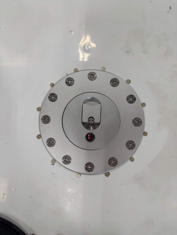

00-Negative Posted April 29 Report Posted April 29 I made some fuel tank covers recently and tried them out this past weekend. I parked outside in north Arkansas for the weekend where we got plenty of rain. My covers stayed on and kept the water out perfectly. I used magnets that stick to the steel center post of the fuel cap. I cut 1/16" abs plastic which I heated to form a concave shape. I tested it in place with a 200mph blower. https://www.amazon.com/dp/B085NP6SQY?ref=fed_asin_title -David 5 Quote
