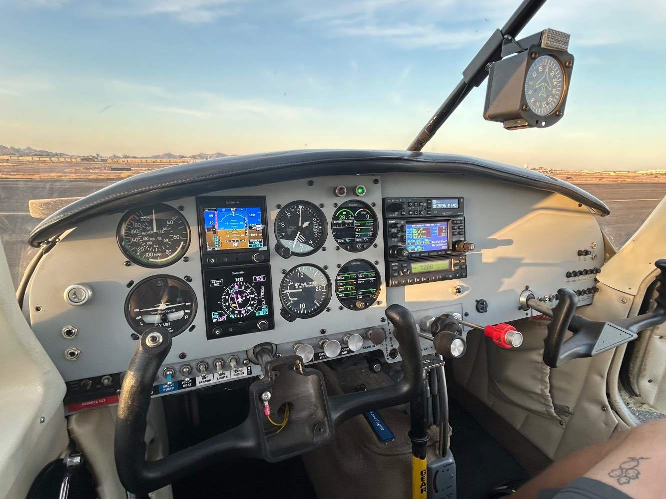

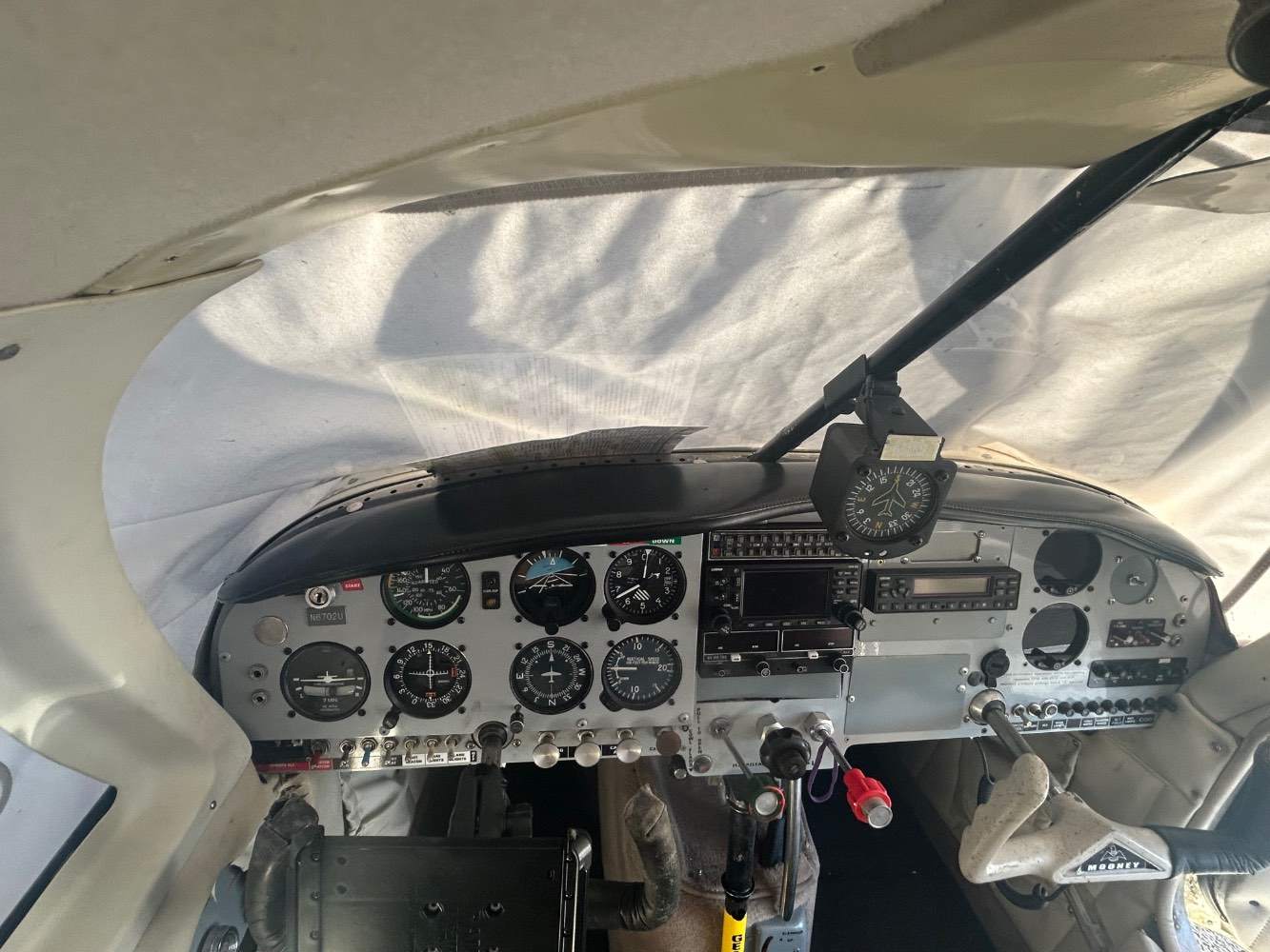

phxcobraz Posted April 24, 2025 Report Posted April 24, 2025 All the things are in. Mechanic is finishing up some last wiring and hopefully can start up soon. Went with 2xG5s and a PAR200B audio panel with a remote com to clean up space. Left some space to do an autopilot soon and probably will swap the 430W with an IFD440 eventually. Passenger ptt will be a button on the panel rather than a janky ptt wrap on the yoke. Stoked to have the CGRs in front of me and not all the way on the right side. How it looked before 9
phxcobraz Posted April 24, 2025 Author Report Posted April 24, 2025 I repainted all the interior plastics as well, and cleaned up the sidepanels, re-glued/stapled peeling leather, looks much nicer. Need to get an order into Hide House one of these days and take the seats over to the shop to get recovered. But I want the plane back for some flying this summer, then will get to it this fall probably. They are fine for now. 1
phxcobraz Posted May 13, 2025 Author Report Posted May 13, 2025 Finished up and flew home the other day. Loving it!! Still a few things to finish with a cover plate on the new left yoke and some nice labels/decals. So tidy, exactly as I had in mind! The PAR200B is incredibly high quality, no alternator whine like my old KMA24. The Trig remote com also works flawless. 4
Ragsf15e Posted May 13, 2025 Report Posted May 13, 2025 1 hour ago, phxcobraz said: Finished up and flew home the other day. Loving it!! Still a few things to finish with a cover plate on the new left yoke and some nice labels/decals. So tidy, exactly as I had in mind! The PAR200B is incredibly high quality, no alternator whine like my old KMA24. The Trig remote com also works flawless. Looks awesome! can you describe exactly what you did to the plastics? They look great and im considering doing mine.
phxcobraz Posted May 13, 2025 Author Report Posted May 13, 2025 8 minutes ago, Ragsf15e said: Looks awesome! can you describe exactly what you did to the plastics? They look great and im considering doing mine. I ended up just lightly sanding and painted them all to match. Most of them are in great shape other than around the screw holes, so I used some interior washers in those areas to reduce more fatigue. The windshield trim has always been poorly fitting and I’m still trying to get that better against the metal backers. Currently just have some Velcro holding it in place. 1

phxcobraz Posted May 14, 2025 Author Report Posted May 14, 2025 36 minutes ago, Echo said: Really looks beautiful. I bet flying behind that new panel puts a huge smile on your face. I would have to put a nice big Aera in an air gizmo on that huge piece of real-estate on the co-pilot side. lol. It for sure does, getting used to the G5s a bit still, but I did do an RNAV approach and the CDI function works great, nice to have it right along side the attitude/alt. Also nice having accurate TAS without having to do math. My plan for the right is a magnet ipad mount that a passenger can use, but otherwise clean when I am flying solo. There is a tray behind the right side holding the Trig com and CGR data boxes, so not as much room as it appears. We did leave enough room to put an autopilot control head just to the right of the 430, probably an Aerocruze or Trig(once it's released) 2
