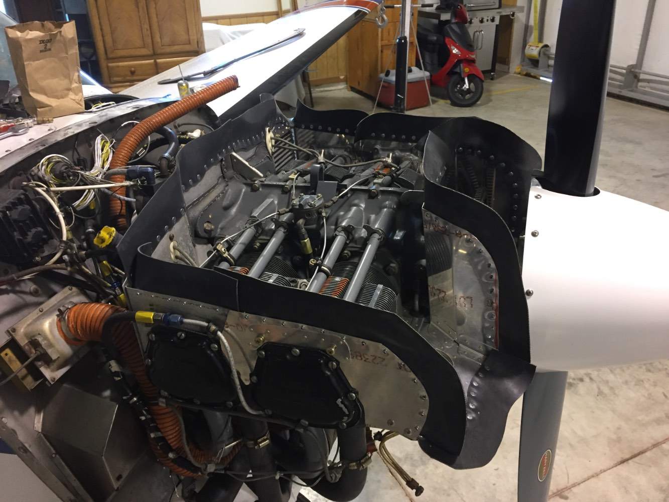

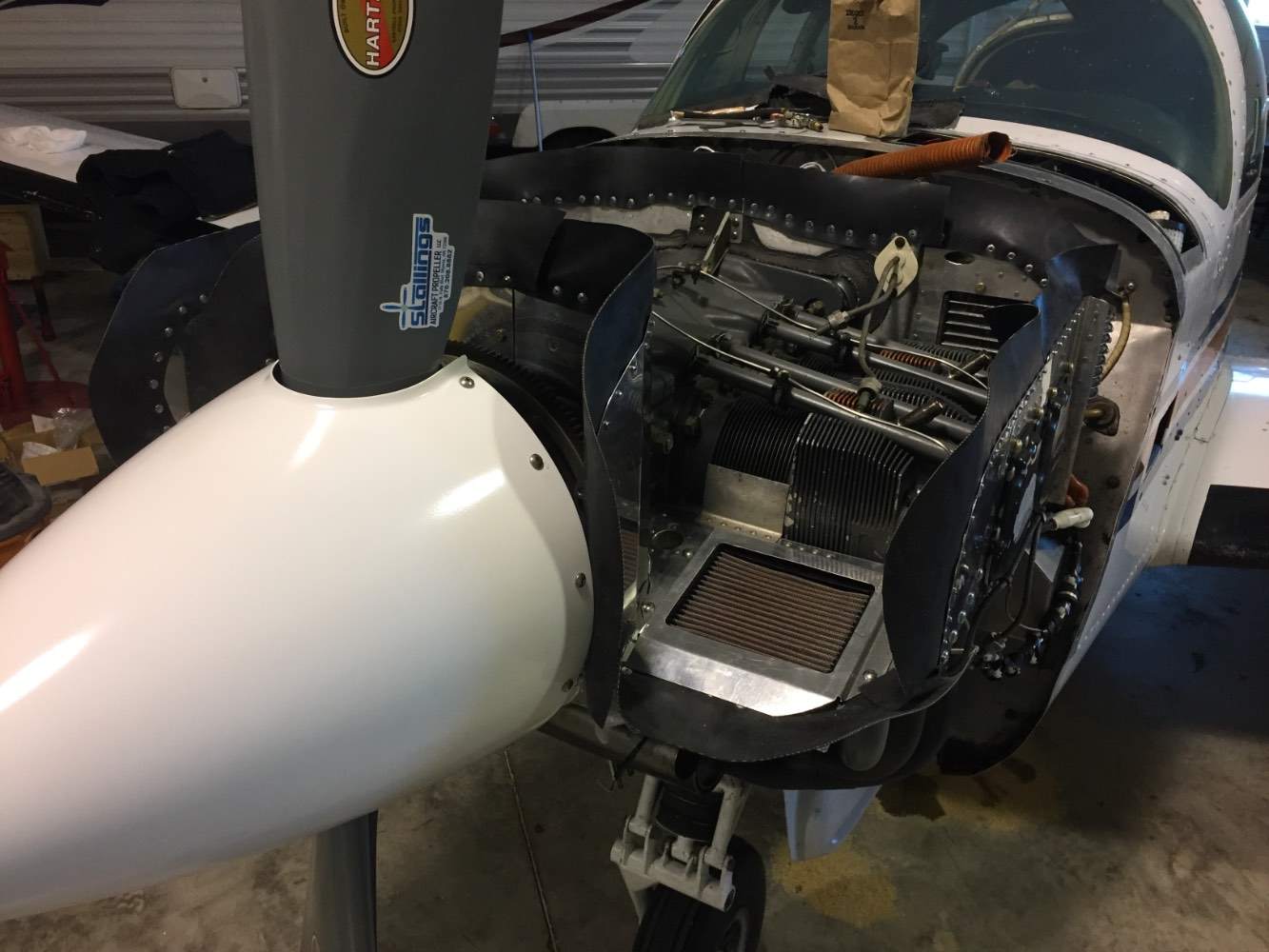

My 67 E has the strengthened upper cowl but with a doghouse on the engine. I’d like to see more pictures / angles of the Vans RV baffling installed on an IO-360 engine Mooney, especially from the front. The back and side baffles are pretty much the same design on all 4 cylinder Lyc’s, but my concern lies with how the intake (ramps) of the Vans-designed baffling work with the traditional pre-J Mooney intake (with Lasar cowl closure mod).
That would be easy to adapt to with keeping the stock intake of the E cowling. I used the Vans composite induction for the IO engine and adapted it to fit inside my cowling mod. For yours, simply leave your lower cowling on and use some tag board to fit the ramps to your lower cowling with the LASAR enclosure, leaving yourself at least a  3/4 inch gap between the ramp edge and the cowling. The cowl seal will take up this gap and keep the baffling from contacting the cowling during engine start and shutdown. Quite simple to do.
Here’s a few photos of the area you’re interested in with the Vans baffling. You won’t be able to fit your air intake like I did unless you change the spinner and get more room. It would be much easier to do yours with just adapting the baffling.
Looks Awesome. These pictures answered a few questions I had when I PM’d you.
