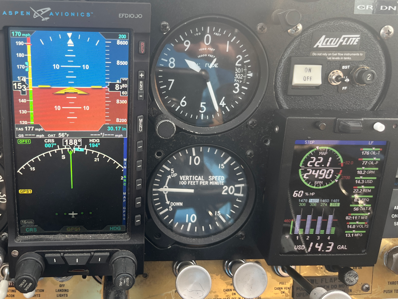

hoot777 Posted Saturday at 12:24 PM Report Posted Saturday at 12:24 PM What do you mean by normalized?? Also I see some installs with altimeter over on the right I think it is more important than the engine monitor. All have a great day. Quote
ArtVandelay Posted Saturday at 12:34 PM Report Posted Saturday at 12:34 PM What do you mean by normalized?? Also I see some installs with altimeter over on the right I think it is more important than the engine monitor. All have a great day.Normalize means you can level all the EGT and CHT readings, makes it easier to spot an outlier. Your readings will never be the same across cylinders.Altimeter on the right is probably a secondary indicator, common for those with graphic displays like G1000, etc.Nowadays the G5 or something similar is used as a backup indicator. Quote
