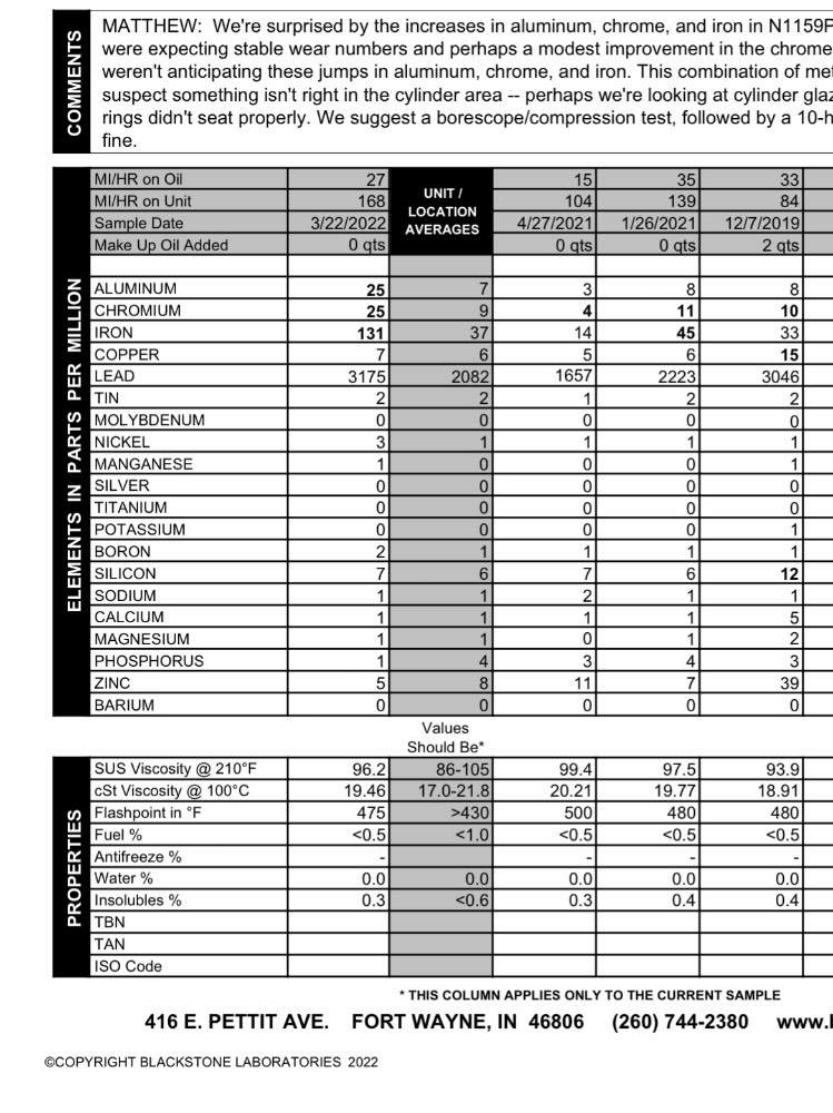

I just got my oil analysis results back from blackstone. Aluminum, Chromium, and iron all up significantly.  My aluminum, chromium, iron, and lead have been elevated since I started doing the analysis. I started at 84 hours since Lycoming factory overhaul, 168 hours on it now. I bought the aircraft after the engine was already broken in. Blackstone attributed the initial higher levels with cylinder break-in. They are recommending borescope and compression check. My compressions at annual in September were 77/78/78/77. Engine is running strong. I haven’t needed to add any oil since at all yet since I bought it. Thoughts?

Here is the complete picture. The two samples to the right of the average column need to be swapped. I sent in two samples at once as and they swapped them. It should have been 4/27/20 and they thought it was 4/27/21.

My first step is to send in another sample. I got about 14 hours on the oil since the last sample.  I talked to my mechanic this morning who thinks he may have screwed up obtaining the sample. He is second guessing himself. I echo Lycoming support. A few weeks ago I attended a seminar at Sun ‘n Fun given by Lycoming field tech support. It was a very informative session.
oil chg dt      tot hrs      hrs since last
12/07/2019     84
04/27/2020    104           20
01/26/2021    139           35
03/22/2022    168           29
Intervals are close enough for direct comparison.  Al, Cr, Fe, and Pb all took a significant jump.
