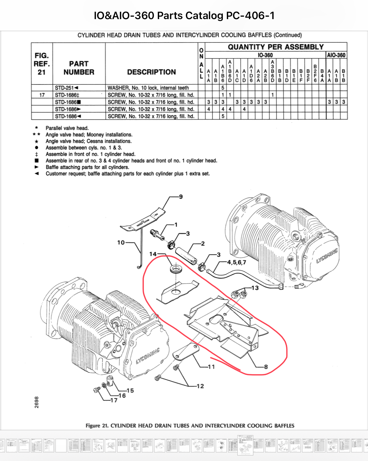

Thanks for the info M20Doc very much appreciated and yes this is the exact piece I am speaking of.
Went back over to the hangar this evening and inspected it a little further and believe I found the reason that their is (incorrectly) a large opening in the lower cylinder baffle (see photos).
A few years back I had a fuel flow meter installed on my plane that works with the EDM display on the plane. It appears that the A&P put the fuel hose that goes up to the fuel distributor (spider) in the incorrect opening (oval shaped opening). Looking at it it appears the correct location is thru the adjacent round hole and the oval shaped hole should be capped (as shown by M20 Doc above).  It appears that a slightly shorter fuel hose will be required and a oval capped installed to remedy the situation.

There's a scary-looking wear mark in the round hole where it looks like a fuel hose was chafing against the sheetmetal.    I wonder if that wasn't one reason it was moved to the larger, oval hole.   :O
The wear mark is actually a relief area for the fire sleeve clamp can pass through the hole.  It also requires a rubber grommet.

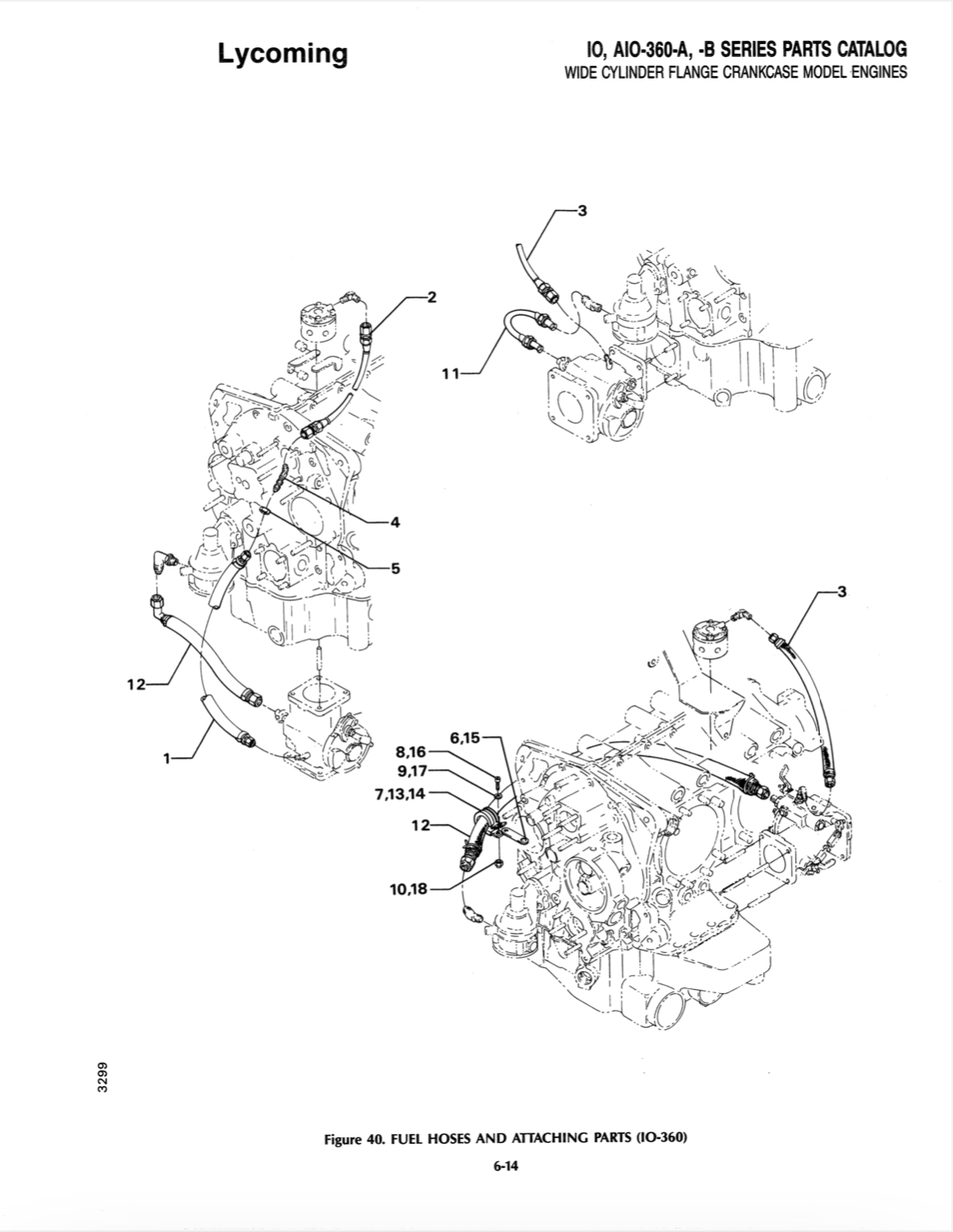

Many thanks for the comments and input on correct placement of fuel flow meter and hose routing. I have a few questions/comments:
1. Is the line that is supposed to be between the servo and distributor block supposed to be a steel line (no breaks) or a hose?
2. Anyone have any pictures of location of the flow meter and where it is installed (between fuel pump and servo) as indicated above?

1. It’s a hose:

It’s a hose from the servo to the flow divider.  The flow transducer normally goes between the fuel pump and fuel servo on 2 hoses.

Many thanks for the information.  Looks like I have some adjustments to do to make this correct and resolve the problem at hand
