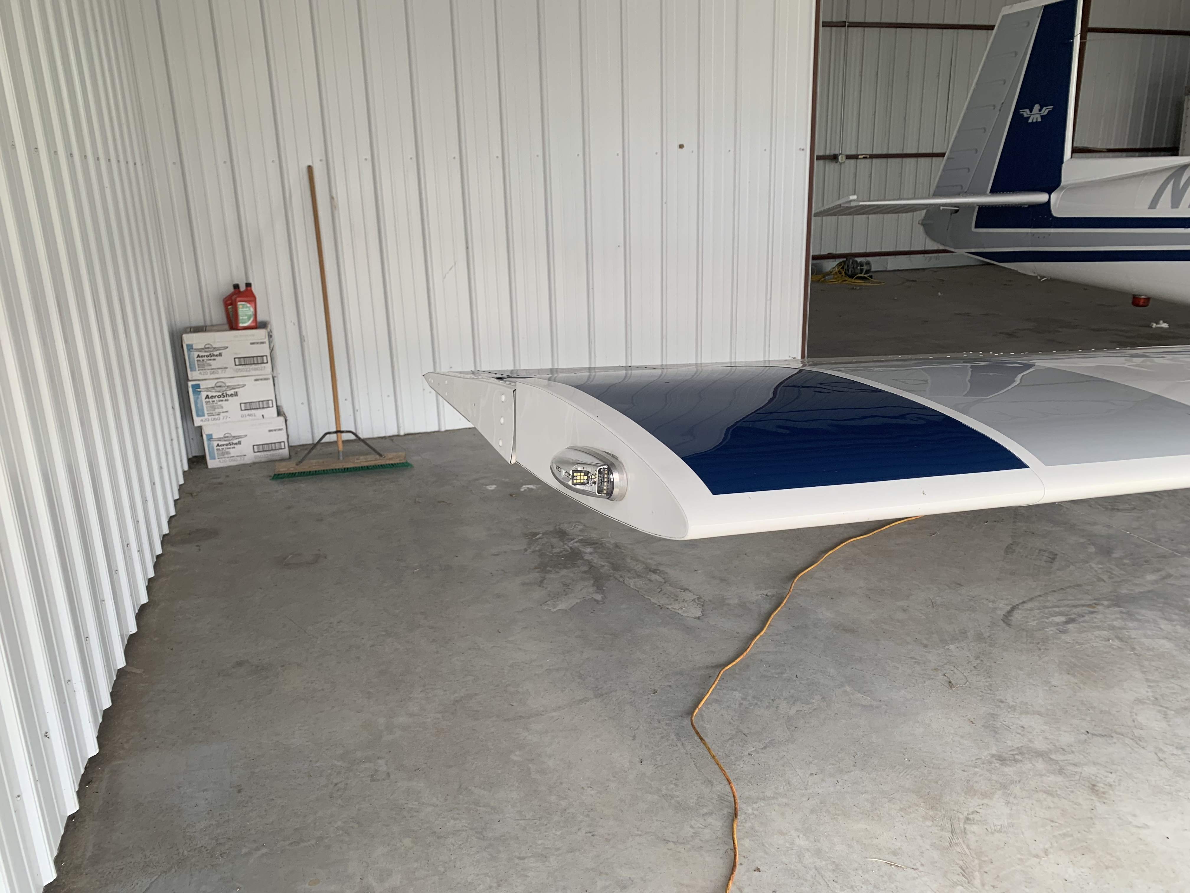

jetdriven Posted August 28, 2019 Report Posted August 28, 2019 4 hours ago, bradp said: The 600s are a bit brighter than the 650s. I’m very happy with the 600s. 77J flat wingtip. How did you mount yours? Pics?
bradp Posted August 28, 2019 Report Posted August 28, 2019 Sure ill take some today. Direct mount same hole pattern as grimes / frankenlight / whelen nav strobes.
bradp Posted August 29, 2019 Report Posted August 29, 2019 Same hold pattern. The wire holes don’t match up exactly between the Orion and the old Grimes. Rather than cut another awkward hole in the side of the wing, I used a grommet and there is enough space under the flange of the Orion that the wires don’t get pinched.
