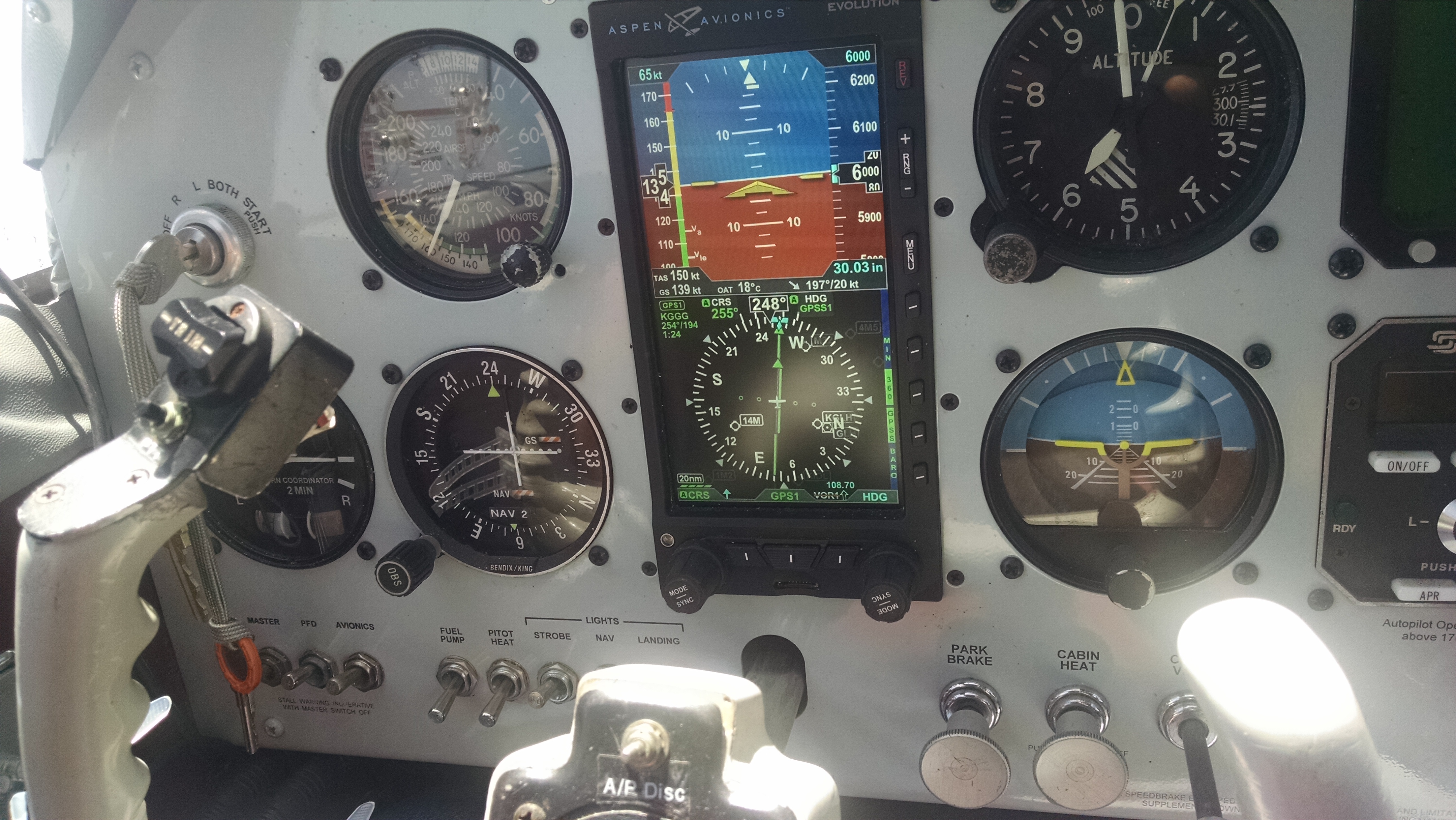

I am about to begin my annual and the ASI needs attention.  It works great but the lens is extremely cloudy, assumedly from cigarette smoke of the past.  My Cessna has a custom IFR panel.  It has A True Air Speed indicator where you can enter temp and it uses altitude to display true air speed.  Sure would love to have one in the Mooney.  Anyone ever have one marked with proper speed ranges for the Mooney?  If I do this it would seem that now would be the time.
any thoughts or experience to share?
My '65 C has the same - though it's the only part on my plane that looks anything like Bob's panel, I think.
I'm guessing it's original, just to give you some other ideas when searching.
Patrick
