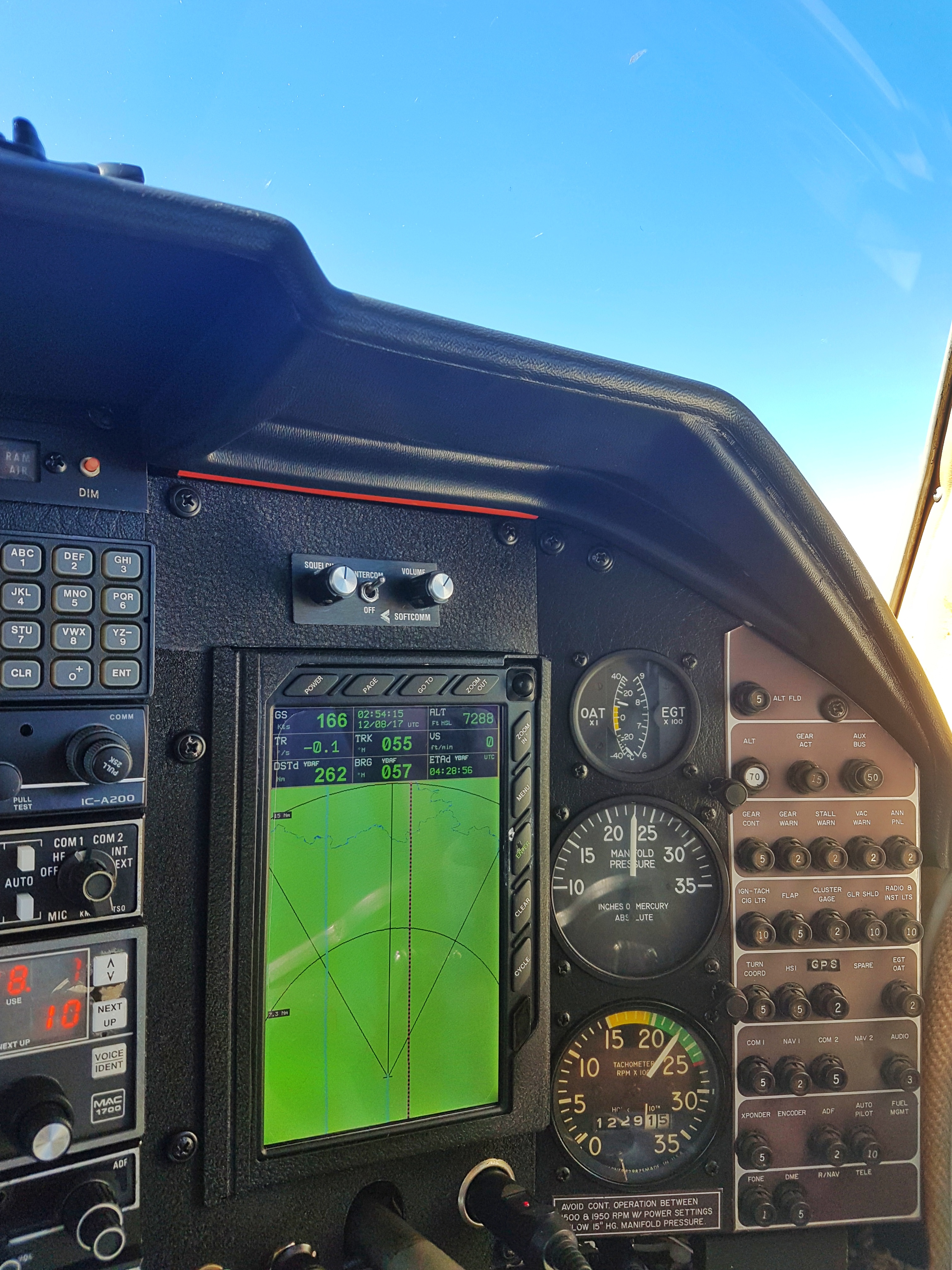

Tommy Posted February 13, 2018 Author Report Posted February 13, 2018 12 hours ago, MIm20c said: @Tommy post up a picture of your panel so we can decide how best to spend the funds. Im starting to look at the Garmin 660 and gdl39(r). The reason I mention this is with a 430w or 650 will give you much needed screen real estate, the adsb weather and traffic (including TargetTrend), flight plan upload to your tablet, and additional data fields. Just a option if you are willing to mount a portable unit in the panel. Here it is. Historical I know! Lol. What would you keep and what you take out? Will you keep Kx175 or IC200? The ADF is above the Kt76 (not pictured)
