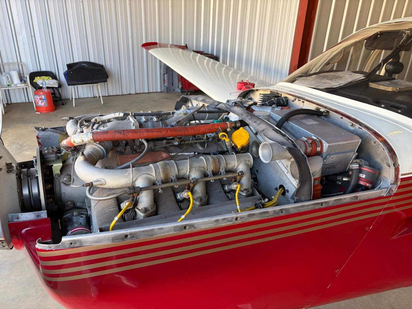

MattSet Posted January 19 Report Posted January 19 Long story short. Purchased a 1982 M20K 231 with an intercooler and automatic waste gate. Annual complete. Plane has not flown for 2 years. But on first flight. At 100 feet over a short runway. Engine had a bad vibration like water in fuel, cleared up after a few seconds but sure got my attention. Manifold pressure on take off was 42. Backed it down to 35. Cylinder temps very high. Number 2 reached 498. Backed manifold pressure down to 25 before able to cool the temps to normal ranges. With number 2 still the hottest at 380 or so. Decided to circle airport and land. Question is. Would not the automatic waste gate keep the engine from over boosting? If working properly. And why would the cylinder temp still be very high at 35 inches pressure and had to drop to 25 to bring temps back to normal. And this was on a 35 degree day. Yes during annual, removed and cleaned all injectors. Also. Who is the best A&P for this type of issue in the South east.

MattSet Posted January 21 Author Report Posted January 21 Thank you all for your input. We tested compression again. All in the low 70’s. Borascoped the cylinders and the A&P said they were the cleanest he had ever seen and found no issues with valves or with anything in them, guess running it hot for a few seconds on take off burned out any carbon LoL. After careful review we have tested and found no issues with fuel flow for each cylinder, all even flow from the spider and decided to order a set of Gami injectors to even out cylinder temps and to keep the manifold pressure 36-38 on take off.

kortopates Posted January 22 Report Posted January 22 Hi @MattSet I keep forgetting to point out that from your picture it sure looks to me like you still have the TCM Diverter valve on your Mooney. Back in 2019 TCM issued Critical Service Bulletin CSB19-01A for fuel diverter valve malfunctions, requiring owners to remove the assembly and reroute fuel to prevent power loss, a critical safety issue due to potential leaks and hydrostatic lock. Apparently it brought down at least one plane. This never made it too required AD status but nevertheless its been taken seriously enough we only rarely see one still in the field - especially after all these years. Recommend you verify if it hasn't been complied with implement it soonest if so. After sitting for a couple years the seals in the diverter are even more likely to cause an issue in flight.
