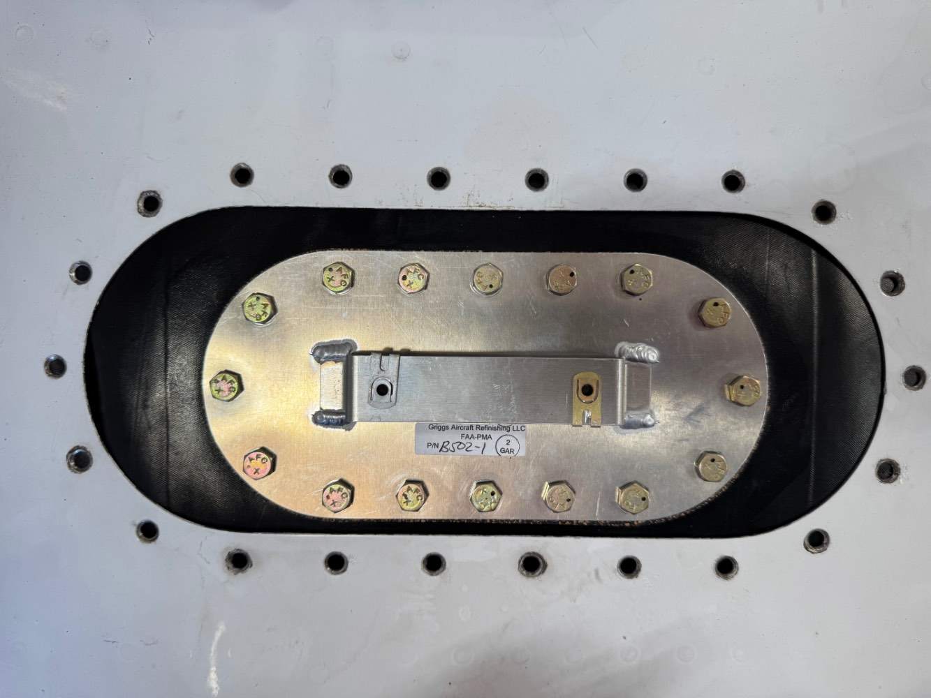

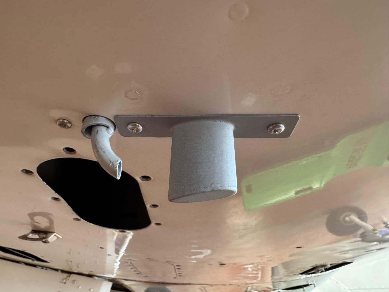

DCarlton Posted April 6 Author Report Posted April 6 For the folks that might be interested in the hardware involved, here's a few more random pics of my bladder install. Vents and drains get removed, relocated and replaced, holes are enlarged in the ribs for the bladder interconnect tubes and covered with centipede grommet, additional small vent/drain holes are drilled in each bladder bay, foam pads are installed in the bottom of the tanks, stringers and rivet heads are taped (the original sealant provides protection too), the inboard bladder is held up by a snap plate, the middle and outboard bladders are held up in position with the plates shown (temporarily out of position) that screw to the original access panels, the original fuel cap adapter ring is removed and new fuel cap adapters and caps are installed, new improved fuel pickup tubes are installed, fuel senders get overhauled or replaced and the gages get fresh labels. I need to make a picture of the new drain valves and tank vent opening (it's an interesting design). I should have made a pic of the spring clamps that get torqued over the bladder interconnect tubes but didn't. Bottom line, there's significant work involved. After seeing the original gunked up fuel pickup tubes and vent tubes, I'm glad those got replaced. I wouldn't say it's superior to a high quality tank reseal but it's an alternative solution that should be field serviceable by any mechanic if needed in the future (a plus if you live in an area where no one wants to patch or reseal tanks). I expect the bladders to outlast the airplane at this point. Looking forward to filling the tanks soon and making sure there are no leaks before we reinstall the interior. Should be downhill from here. 1 1
