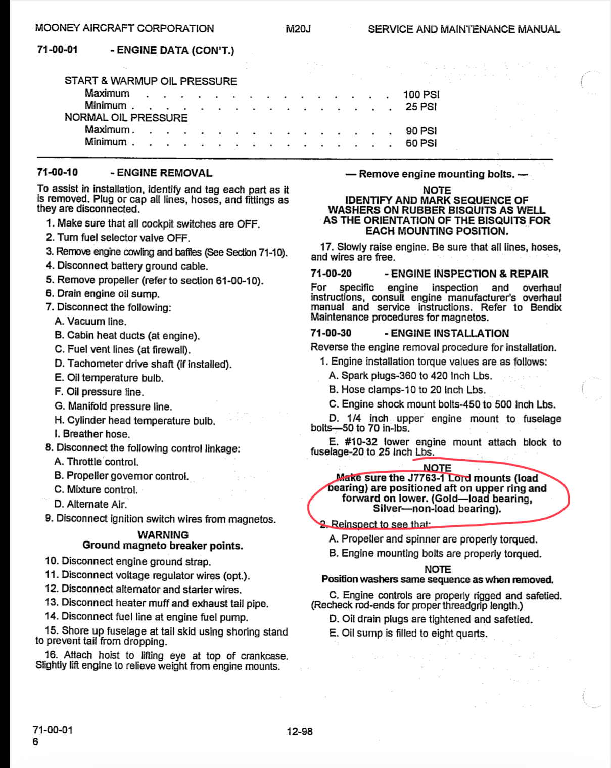

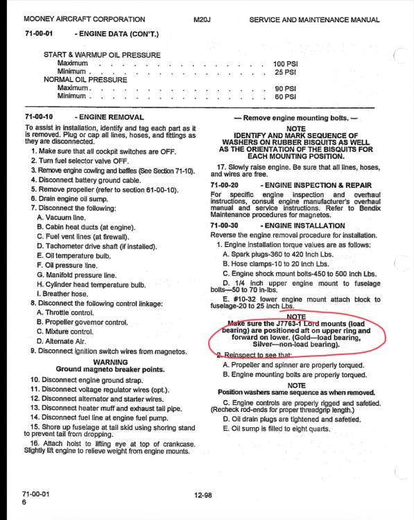

Guest Posted November 15, 2020 Report Posted November 15, 2020 2 hours ago, Nukemzzz said: 66 E. Top one has a 90 degree end. Bottom is straight out. Both go down the tunnel behind the engine and under a heat shield on the bottom of the cowl to the cooler at the nose. I believe that your Lord mounts are installed backwards. The ringed mount is normally installed on the aft side of the mount on the uppers, and forward of the mount on the lowers. Clarence
Nukemzzz Posted November 16, 2020 Report Posted November 16, 2020 22 hours ago, M20Doc said: I believe that your Lord mounts are installed backwards. The ringed mount is normally installed on the aft side of the mount on the uppers, and forward of the mount on the lowers. Clarence No kidding? I wonder why this would be? Is the non-ring bushing bigger to hold the engine weight better? Where could I find this documented to show my shop? Thanks
