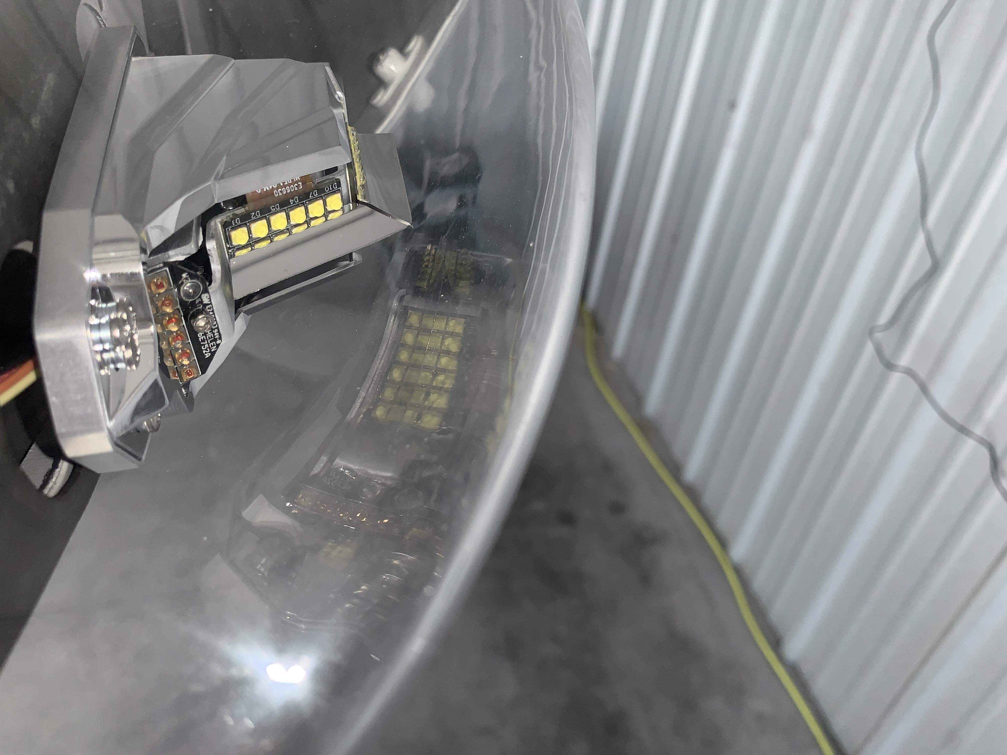

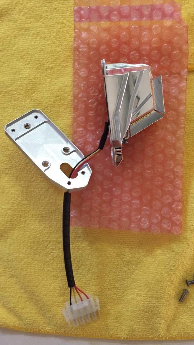

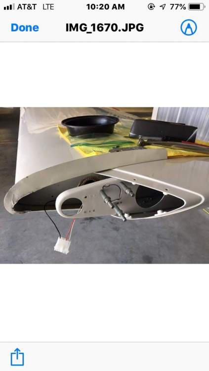

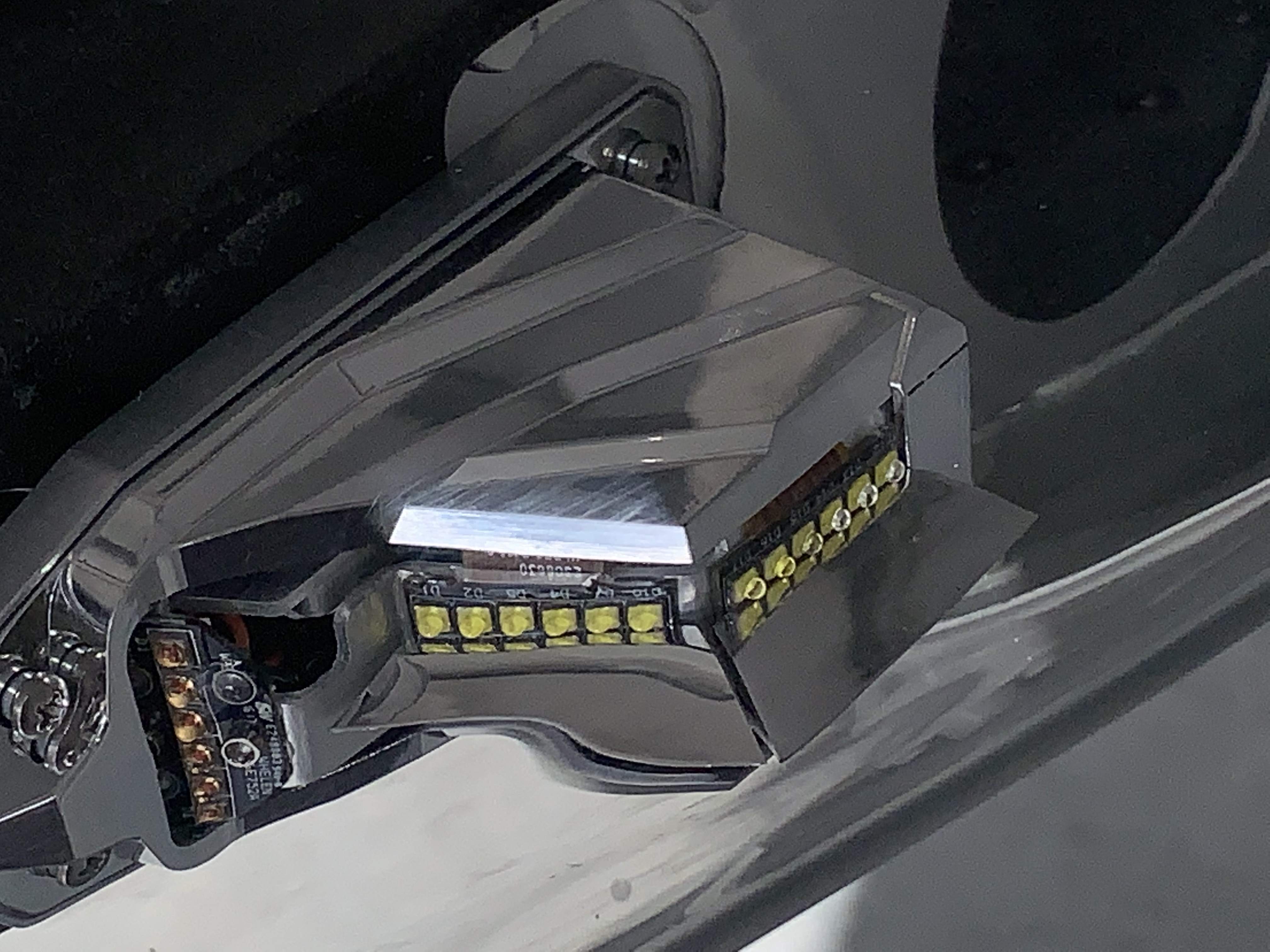

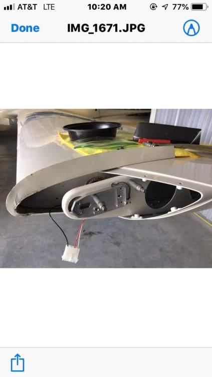

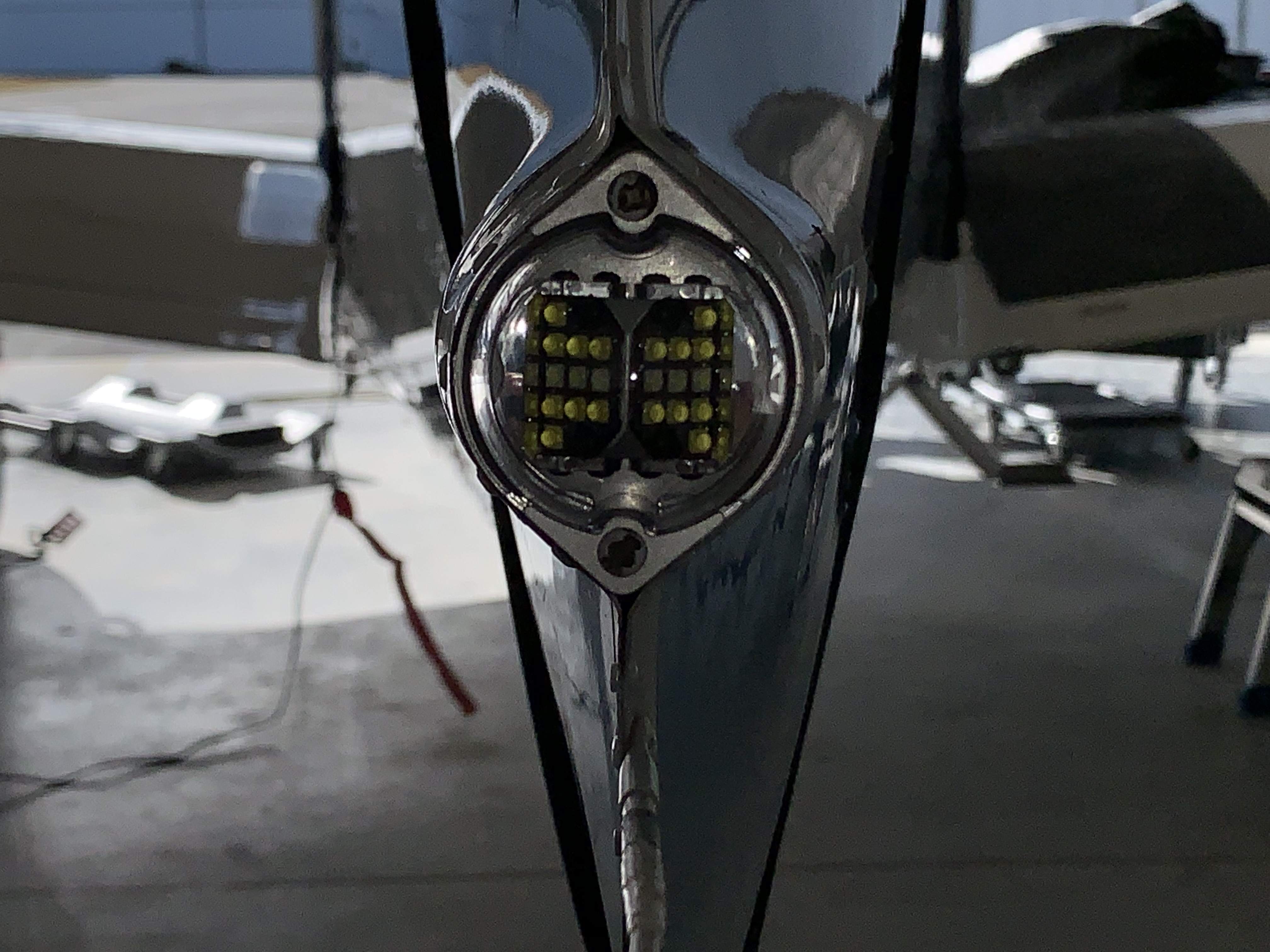

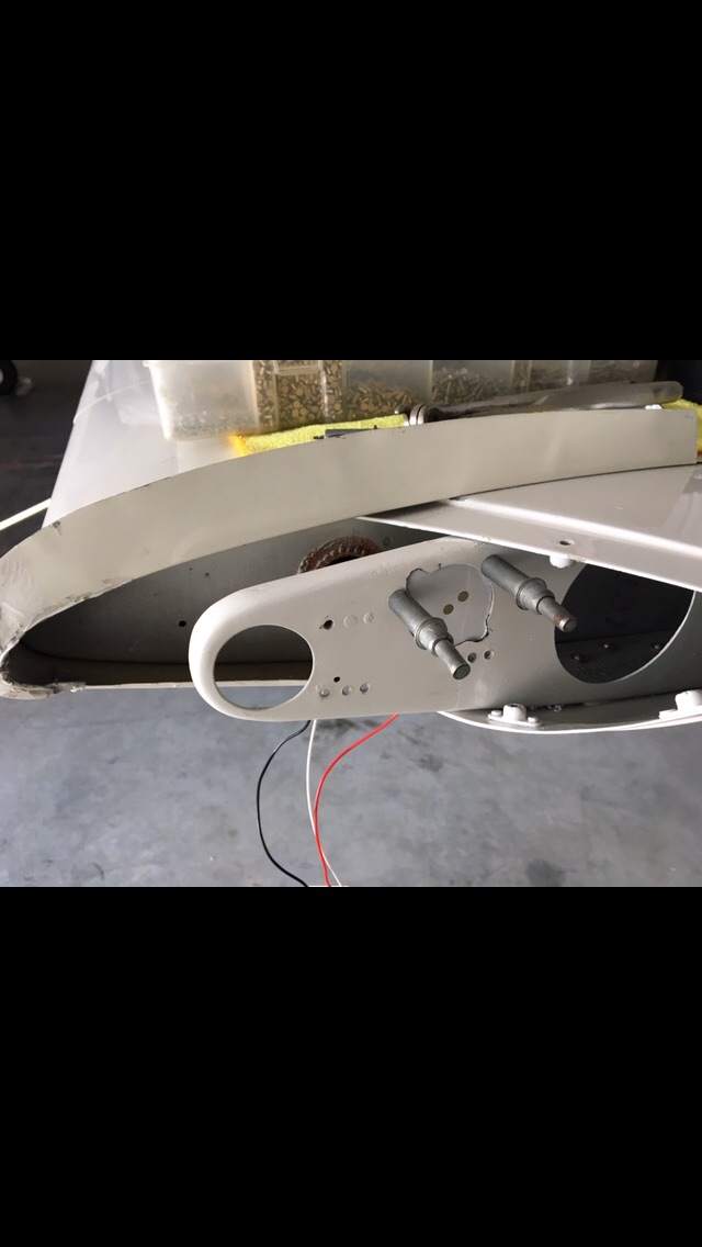

KB4 Posted December 30, 2018 Report Posted December 30, 2018 Huge thanks to MS ers for the help especially StevenL757 who flew in to personally help me. Didn’t sync but will do at next annual. AC/Nav brackets holes did not line up with existing nut plates so needed a little fab work to complete. Used existing power and ground from old power supplies which were all removed. Saved about 6lbs but need a more accurate scale for exact #. Unbelievable difference in brightness intensity. 6 1
bradp Posted December 30, 2018 Report Posted December 30, 2018 Those look straight up mean. Nice work with the flush patch. 2
StevenL757 Posted December 31, 2018 Report Posted December 31, 2018 I agree. Shout out to Ed from Ed’s Aircraft Refinishing at Brookhaven Airport (KHWV) for helping with this work as well. Steve 1
