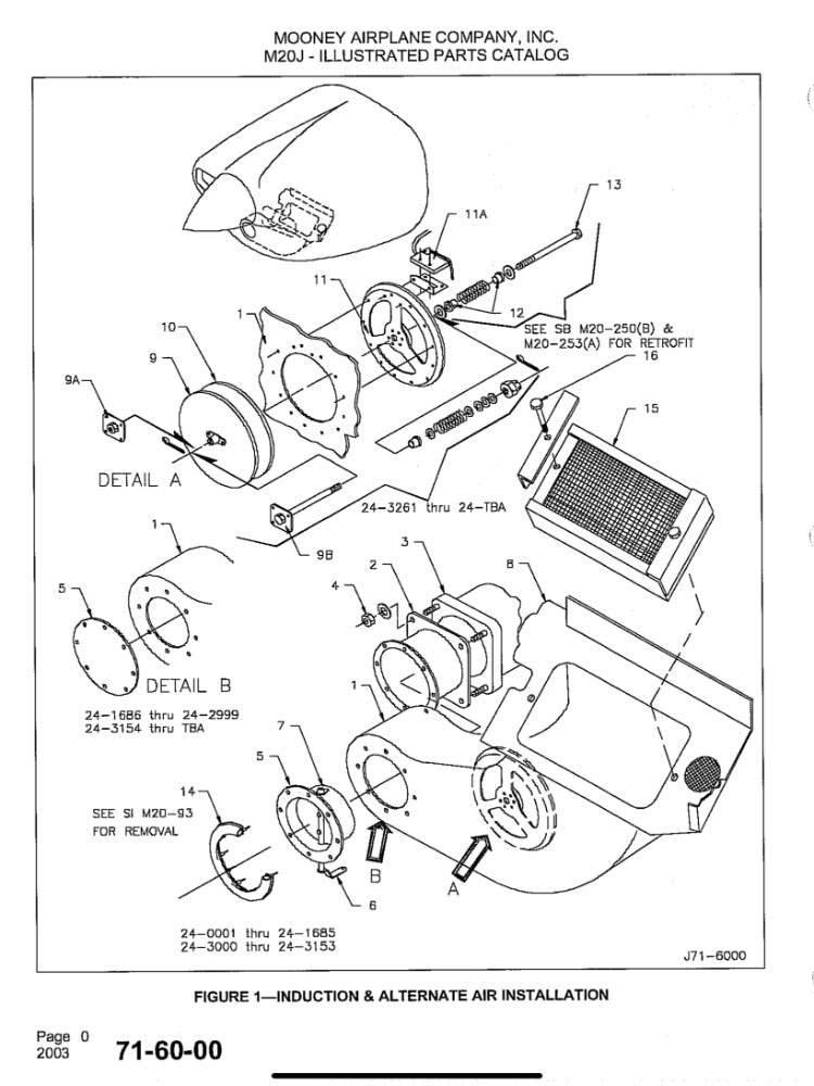

PT20J Posted January 25 Report Posted January 25 Parts catalog does show a gasket between the air induction assembly and the flange assembly or between the flange assembly and the servo. Probably someone made a gasket on yours. 1
Slick Nick Posted January 25 Report Posted January 25 @PT20J which page did you find it on? It’s not shown in the IPC for my MSE. I know there is a gasket between the servo and the manifold, but I can’t find one shown between the servo and airbox.
N201MKTurbo Posted January 25 Report Posted January 25 You are looking in the Mooney manual, @PT20J was showing the engine manual.
Slick Nick Posted January 25 Report Posted January 25 1 minute ago, N201MKTurbo said: You are looking in the Mooney manual, @PT20J was showing the engine manual. Yes I know, the engine manual shows one between the servo and intake manifold, I’m looking for a reference for a gasket between the airbox and servo, which would be in the Mooney manual. Can’t seem to find one pictured or described.

Slick Nick Posted January 25 Report Posted January 25 1 minute ago, N201MKTurbo said: Oh, sorry No problem. I’m just trying to see if there is supposed to be one there, I can’t recall if my plane ever had one, I’ll need to look next time I have the cowl off. Edit: If it’s not supposed to have one, would installing one be such a bad idea? The two surfaces are pretty flat machined, so maybe it’s not required, but surely it couldn’t hurt?
mhrivnak Posted January 25 Report Posted January 25 I agree it seems to be an oversight that the gasket on the forward side of the fuel servo is not mentioned in the M20J IPC (even though it's drawn on the diagram at 76-00-01) nor in the IO-360-A IPC. Here's what I've found when I've gone looking: PN 77504 gets used with the RSA-5AD1 fuel injector on the forward side between it and the air box, at least as documented in some IO-360 IPCs (but not ours). The IO-360-P1A, IO-360-N1A, and IO-360-M1A IPCs show the same fuel injector we use (RSA-5AD1) and specify gasket 77504. The latter includes the note "Install between the fuel injector and the airframe air box". Of course those are not IPCs for our engines, but it's a pretty close reference since they use the same fuel injector. Even the IO-390-A IPC shows gasket 77504 in front of the RSA-5AD1, and that engine can actually go on our airplanes (with an STC from Lycoming). Our engine IPC was last revised in 1995, compared to all of the others mentioned above which are much newer; perhaps Lycoming noticed the oversight and saw fit to start mentioning it at some point? It would sure be nice to have direct documentation associated with our specific engines and/or airframes. Edit to correct the diagram reference in the Mooney IPC. 2
mhrivnak Posted January 25 Report Posted January 25 Here it is shown in the airframe IPC without any other information.

PT20J Posted January 25 Report Posted January 25 12 hours ago, mhrivnak said: Here it is shown in the airframe IPC without any other information. This drawing is for the control installation. The drawing @Slick Nick posted is the correct drawing for the induction system installation. The gasket shown on the control installation drawing is likely an error, but the fact that it does not have a reference number indicates that it is not part of this drawing. The purpose of the drawings in the IPC is to identify parts; they are representational and not actual assembly drawings. I don't recall there being any gasket there when we replaced my engine. But, as always, if there is any question, contact Frank Crawford at the factory because he has access to the actual manufacturing and assembly drawings. I would be very careful about adding a gasket that has any significant thickness. The clearance between the cowling and the lower metal air baffle is minimal and if the baffle is pushed forward it can damage the fiberglass cowling. 1
