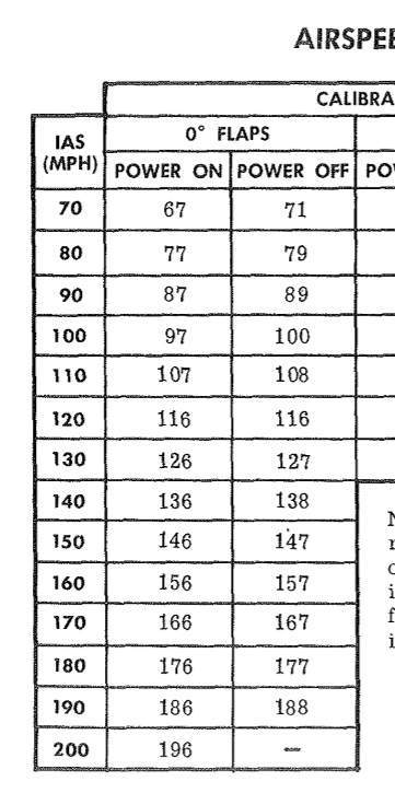

Hank Posted yesterday at 02:00 AM Report Posted yesterday at 02:00 AM 9 minutes ago, PT20J said: The problem, as we may recall from private pilot ground school, is that that the largest airspeed errors (spread between IAS and CAS) usually occur at low airspeeds because the pitot tube is no longer aligned with the relative wind due to the increased angle of attack. Then how do you explain THIS: Power Off CAS = IAS - 1 at low speeds, climbing ti IAS - 3 at higher speeds. 1
ptwffz Posted yesterday at 02:42 AM Author Report Posted yesterday at 02:42 AM 40 minutes ago, Hank said: Then how do you explain THIS: Power Off CAS = IAS - 1 at low speeds, climbing ti IAS - 3 at higher speeds. All I'm gonna say is I wish that chart was in my Owners Manual. I'd be golden.

varlajo Posted 7 hours ago Report Posted 7 hours ago 17 hours ago, ptwffz said: All I'm gonna say is I wish that chart was in my Owners Manual. I'd be golden. My E is 1 - ONE - mph CAS over MOSAIC cutoff

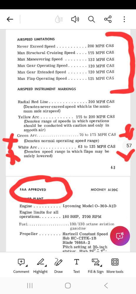

ptwffz Posted 6 hours ago Author Report Posted 6 hours ago The above airspeed indicator was copied from a different post. The owner states it's from his M20 D/C model which is exatly mine. Granted I don't know his year but there's a big difference in his VSo and VS1. Both way lower than mine. What the !!!!!!!!!

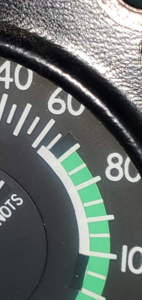

ptwffz Posted 6 hours ago Author Report Posted 6 hours ago This is my airspeed indicator. It looks like someone placed black tape over the bottom of the green arc. Like I said, maybe the other airspeed indicator shoud be in my bird. Is my Owners Manual incorrect? I have a 1964 M20D Master and my manual says 1965. I doubt it changed by one year. Nothing is making sence here. Or I'm retarted.
ptwffz Posted 5 hours ago Author Report Posted 5 hours ago I just noticed the top of my white arc is taped over as well.
Hank Posted 2 hours ago Report Posted 2 hours ago For my 1970 C, the Owners Manual says the green stripe is "the normal operating range" and makes no mention of stall. You really need something like the table I posted before, but for a model year closer to yours, since control throws changed over the years.
