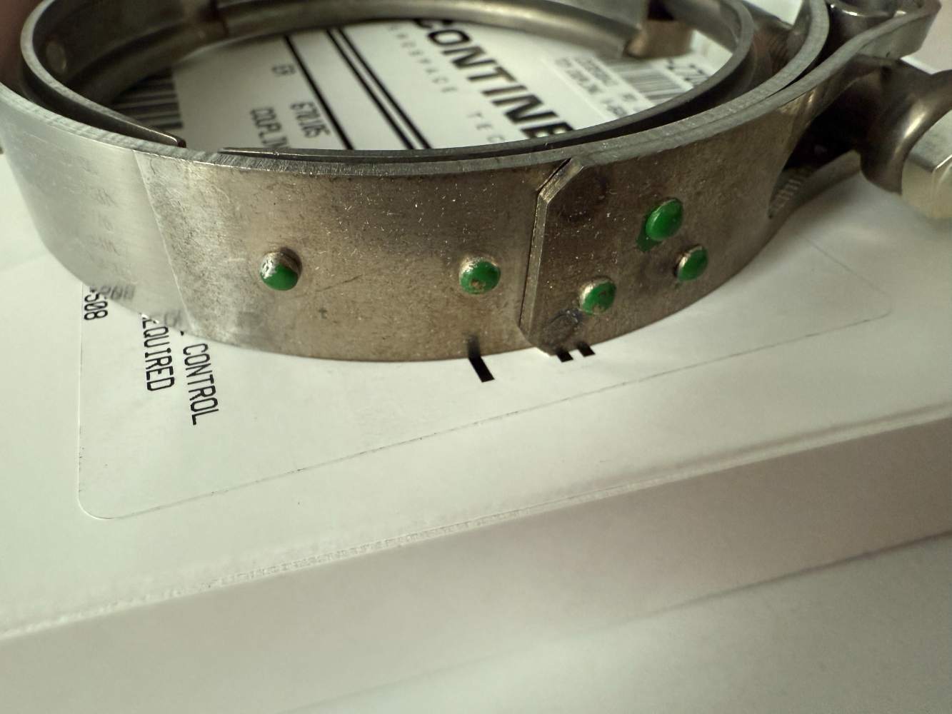

Pritch Posted May 10 Report Posted May 10 (edited) Received my clamp today and after inspection there are no spotwelds only riveted. There is also no way that one could add rivets to their old ones as the outer rivets are put in first and then the v band part is attached. Pritch Edited May 10 by Pritch Quote
