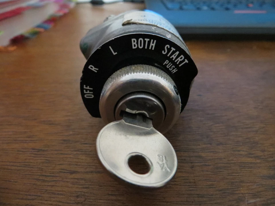

Does your ignition have a "push" position like this one?

Rarely is the SOS box itself truly the problem; it's not hard to replace if it is...though mounted in an awkward location on cabin side of the firewall.  I think what Ross is referring to is that you can crank it forever in start position and then it only fires immediately you give up and move it back to both position. That could be a dead SOS box, it also could be a problem with the left mag.  If you turn key to both without pushing in to engage the starter, you can hear the SOS buzz and likely that's fine.  If you don't hear the buzz its the SOS box, its connection to the battery, or its connection to the ignition switch.

Yes, looks the same.
First thing I would do is check to see if the starter vibrator is buzzing with the key in the start position.  That is to say with the key turned all the way to the right but not pushed in you should hear the high pitched buzzing sound of the energized starter vibrator. Note this has nothing to do with the engine's starter.
That's the first and least invasive check.
