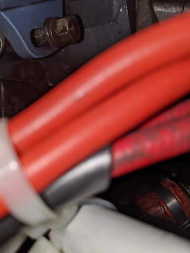

I'm still working on my conversion that I started in September.  I work slow, and my hangar is not heated so I have not been out there as much as I'd like with well below average winter temps this season.  Holiday commitments, and dealing with my father's passing in November have all prevented me from finishing as quickly as I had hoped.
I believe EA estimates 50 hours of installation hours.  They cannot give an exact figure because every application and every individual plane is different in terms of the integration required.  I'll probably be closer to 100 hours of labor before I'm finished, but I work slow.  It is a SUBSTANTIAL installation task.
  • A backup battery in the tail
  • routing a harness to the panel (and their harness is way too short!)
  • fabricating a new key switch panel to hold their big mag switch and start button
  • finding a home for the backup battery meter and switch panel
  • finding homes for two controller boxes behind the panel
  • plumbing and routing a new MP line to feed those
  • adding a bunch of new circuit breakers somewhere
  • connecting all of those electrical bits at the panel
  • routing two electrical harnesses through the firewall
  • finding homes and installing two coil packs in front of the firewall
  • routing new spark plug wires AND maintaining 1/4" separation between wires for the entire run
  • R&R the prop to install the timing ring on the crank shaft, and the associated bracket and sensor, plus routing that wire over the engine case
I think it will be worth it, and I'm very much looking forward to being done with the D3000, even though it has not given me too much grief in 17 years.  Working on and improving my plane is my primary hobby these days, so that is what I do.  If I had to pay $5k+ for someone to install the $6k hardware, I might be happy keeping a D3000 going for a while longer.  YMMV.  I hope to give a PIREP soon enough, but it was below zero again this morning so I will not be working on it today.  ;)
FWIW, I am hanging on to one of my D3000 mags, key switch, and left the P-lead wires intact just in case I need to go back to what I had...  Hopefully I'll be selling all of those this spring.
