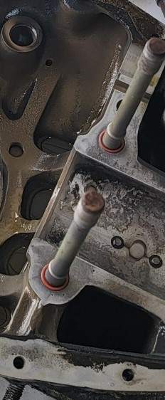

JimB Posted June 10, 2022 Report Posted June 10, 2022 3 hours ago, tgardnerh said: This part seems risky from a regulatory standpoint--it's removing metal and adding something squishy in an area where preloaded is critical. (see the current thread going on oil leaks and engine cases) Is it something that is within the scope of a&p discretion, or does he have specific approved data to do that? Sent from my iPhone using Tapatalk This is from a narrow deck O-360 we just removed from a Comanche. Is this what your talking about? All them had a o-ring and there is already a groove around the base of each thru bolt. Quote
N201MKTurbo Posted June 10, 2022 Report Posted June 10, 2022 Here is the Service Instruction that authorizes the O-rings. There is another Service Instruction for adding O-rings to doweled crankcases. http://nebula.wsimg.com/e25dfd622fa874f440fa6d8f405274d6?AccessKeyId=4F9A3E91CE7CAB506B89&disposition=0&alloworigin=1 2 Quote
