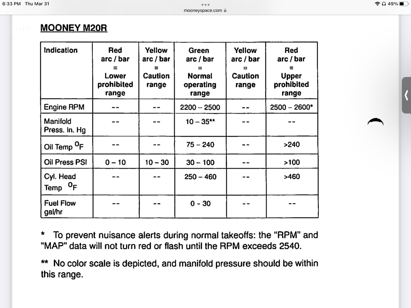

atpdave Posted March 31, 2022 Report Posted March 31, 2022 On 3/30/2022 at 5:12 AM, A64Pilot said: I’ve never flown any of the fancy new glass like the G1000’s etc. how do they handle the issue? Here is how the Ovation 2 G1000 handles tach alarms: Pages from 09 Supplemental Data.pdf 1 1 Quote
carusoam Posted March 31, 2022 Report Posted March 31, 2022 Fantastic details ATPD! It specifically states how to handle the nuisance alarms… during T/O! Share that with the engine monitor folks... @oregon87 (something that may be of interest to your alarm handling people during T/Os… direct from G1000 Mooney supplemental data.) Best regards, -a- Quote
A64Pilot Posted April 1, 2022 Report Posted April 1, 2022 See the manufacturer wrote limits to accommodate the new gen instrumentation, Lycoming and Continental should come on board and re-write their limitations to accommodate the new instrumentation. I assume those limits came from Mooney, with the engine manufacturers support? Garmin apparently has broken the code as reported earlier with the G3X if I stated that correctly, maybe now all the other manufactures can follow suit and allow the operator to set alarms? We still fly behind our Grandfathers engines, but we don’t monitor them with his gauges 1 Quote
