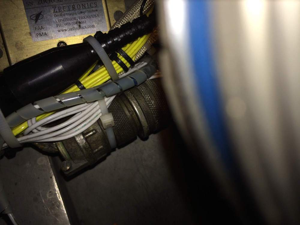

Ragsf15e Posted May 16, 2019 Author Report Posted May 16, 2019 On 5/3/2019 at 6:50 AM, N231BN said: Also, inspect the field wire from the VR to the ALT. Look for frayed connections at either terminal or a partial break along the wire. This will limit the field current available which will limit the ALT's output. This post may have nailed it. I’ve been through the whole electrical system with a multimeter and I think I’ve got it down to an issue with the field wire. Here’s the problem, the 2 x cannon plugs make it almost impossible to get a voltage output from the Voltage Regulator at the Voltage Regulator. I can’t get to the wires to check them with power on to the VR. I did check the field wire at the alternator, and its 2V less than the input to the VR. That’s right on the bottom of their spec range. I measured the resistance of the field wire and it’s high, like 10 ohms. Heres my question, does the field wire really go through both the black plastic cannon plug and the big metal one in the picture? Why? Is it possible to simplify this wiring? Is there another way it should be?

Ragsf15e Posted May 16, 2019 Author Report Posted May 16, 2019 5 minutes ago, carusoam said: For simplicity of wiring... My 65C was probably wired directly... single wire from generator field to controller field. 10 ohms sounds kind of high for what should be a 0 ohm direct connection... PP thoughts only, not a mechanic... Best regards, -a- Yep, I agree with both. Mine is a 68F, it seems that a direct field wire from VR to Alt would be fine, but no such luck. The bigger metal cannon plug looks old. Like maybe original? And yes, 10 ohms is definitely high. I want to tear into those cannon plugs, but I think I’ve hit my limit, maybe time to get my IA on this.

Yetti Posted May 19, 2019 Report Posted May 19, 2019 I have found the cannon plugs are not immune to corrosion. Sometimes taking them apart and putting them back together makes them good for another couple years.
N231BN Posted May 19, 2019 Report Posted May 19, 2019 This post may have nailed it. I’ve been through the whole electrical system with a multimeter and I think I’ve got it down to an issue with the field wire. Here’s the problem, the 2 x cannon plugs make it almost impossible to get a voltage output from the Voltage Regulator at the Voltage Regulator. I can’t get to the wires to check them with power on to the VR. I did check the field wire at the alternator, and its 2V less than the input to the VR. That’s right on the bottom of their spec range. I measured the resistance of the field wire and it’s high, like 10 ohms. Heres my question, does the field wire really go through both the black plastic cannon plug and the big metal one in the picture? Why? Is it possible to simplify this wiring? Is there another way it should be? When you checked the field wire was it disconnected at both ends? 10 ohms sounds about right for the field winding if you still had it connected to the alternator. 1

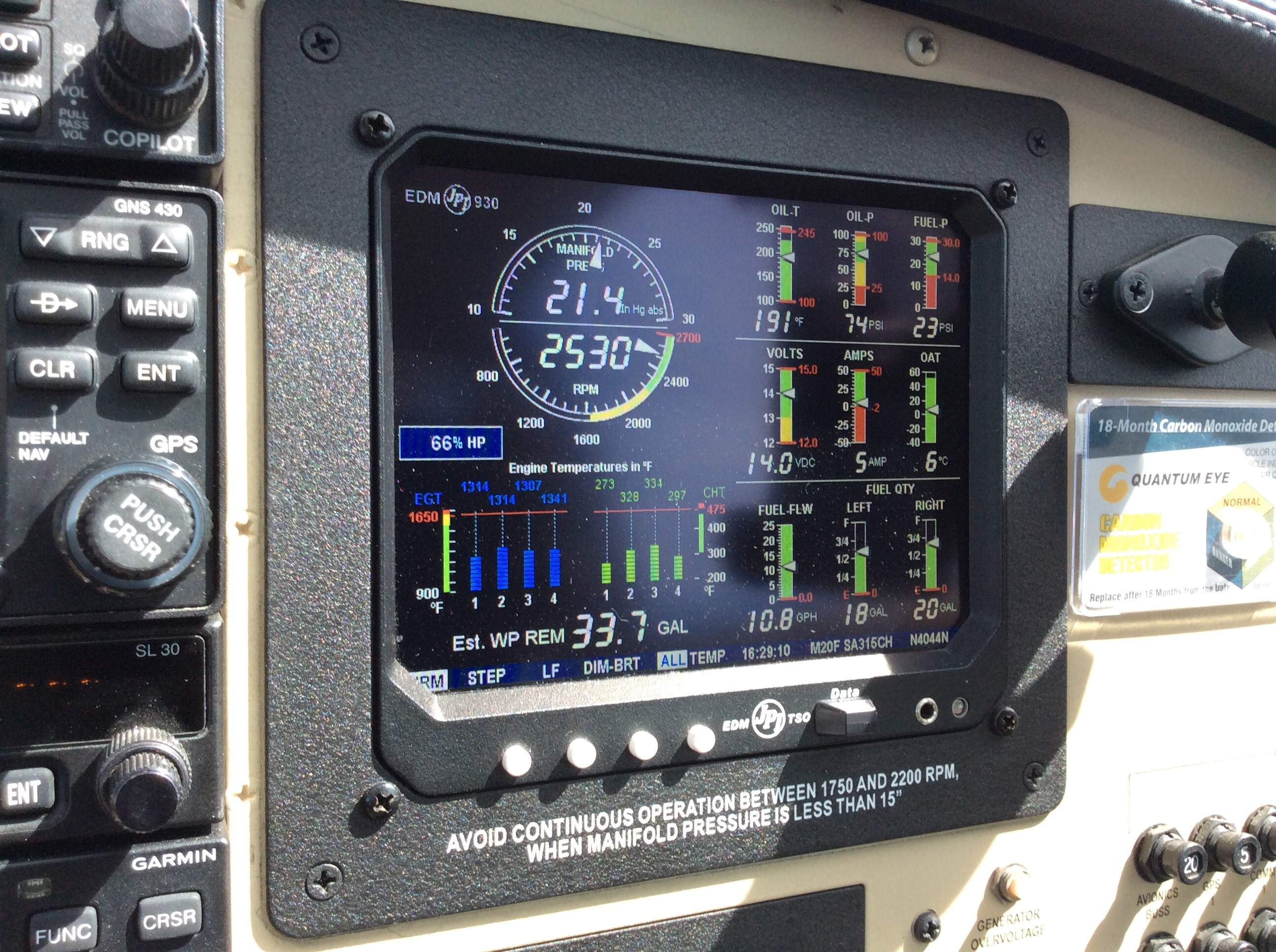

khedrei Posted September 21, 2021 Report Posted September 21, 2021 (edited) I will revive this "gem" of a thread to add in my own issue and maybe someone can nudge me towards a solution. I have a 1980 231. 14V. I have a G500Txi with the Bus voltage and the amps displayed digitally on the engine monitor strip on the right hand side. I will try to find an example pictures but I think that because I have the voltage displayed constantly might help troubleshoot and eliminate some of the places I might need to test. I have gone through RagsF15e's posts and some of those seem plausible. I had the aircraft battery replaced last year. Situation is this: after start up the voltage only goes up to about 12.2-12.5ish and the amps show a discharge of -15 and once the avionics are turned on it jumps to -25. The factory low voltage annunciation above the radio stack flashes. When I got to doing the run up and revved everything up it went back to normal and I showed 14V and +2 amps for the whole flight. On the way home same thing happened right after start up. This time even before the run up I simply shut off the master and turned it back on and the problem went away and it was fine for the whole flight. My friend flew it a while ago and he said that happened to him and that was the first time I had heard of it happening. He reset the master and problem was solved. It didn't do it again until 2 months and 15+ flights later. Now it seems reasonably consistent. I will try it again tomorrow on the ground and see if it does it again. Resetting the Alt field CB doesn't seem to do anything. The master was able to solve the problem at least twice now and the other time it simply went away during the run up. Has me wondering if its an issue with the second pole on the master switch turning on the alternator field (as mentioned above), or possibly a bad voltage regulator. The VR is under the copilots left knee under the panel and easy to access, though the harness/connections would make it tough to check any voltage there. The other option mentioned above is the jumper between the power bus and the main bus.... where would I find this connection? Is that at the battery near the aux power outlet? The are no obvious signs of frayed or damaged wires but the fact that this started off as very intermittent and has gotten progressively worse has me leaning towards a bad VR. The wire that looks to go to the VR from the alternator does seem to have a small bit of oil on it (as does the general area like a small mist) but otherwise the connections are all fine and there is no obvious damage. Any input is appreciated. Kevin Edited September 21, 2021 by khedrei spelling
Ragsf15e Posted September 21, 2021 Author Report Posted September 21, 2021 1 hour ago, khedrei said: I will revive this "gem" of a thread to add in my own issue and maybe someone can nudge me towards a solution. I have a 1980 231. 14V. I have a G500Txi with the Bus voltage and the amps displayed digitally on the engine monitor strip on the right hand side. I will try to find an example pictures but I think that because I have the voltage displayed constantly might help troubleshoot and eliminate some of the places I might need to test. I have gone through RagsF15e's posts and some of those seem plausible. I had the aircraft battery replaced last year. Situation is this: after start up the voltage only goes up to about 12.2-12.5ish and the amps show a discharge of -15 and once the avionics are turned on it jumps to -25. The factory low voltage annunciation above the radio stack flashes. When I got to doing the run up and revved everything up it went back to normal and I showed 14V and +2 amps for the whole flight. On the way home same thing happened right after start up. This time even before the run up I simply shut off the master and turned it back on and the problem went away and it was fine for the whole flight. My friend flew it a while ago and he said that happened to him and that was the first time I had heard of it happening. He reset the master and problem was solved. It didn't do it again until 2 months and 15+ flights later. Now it seems reasonably consistent. I will try it again tomorrow on the ground and see if it does it again. Resetting the Alt field CB doesn't seem to do anything. The master was able to solve the problem at least twice now and the other time it simply went away during the run up. Has me wondering if its an issue with the second pole on the master switch turning on the alternator field (as mentioned above), or possibly a bad voltage regulator. The VR is under the copilots left knee under the panel and easy to access, though the harness/connections would make it tough to check any voltage there. The other option mentioned above is the jumper between the power bus and the main bus.... where would I find this connection? Is that at the battery near the aux power outlet? The are no obvious signs of frayed or damaged wires but the fact that this started off as very intermittent and has gotten progressively worse has me leaning towards a bad VR. The wire that looks to go to the VR from the alternator does seem to have a small bit of oil on it (as does the general area like a small mist) but otherwise the connections are all fine and there is no obvious damage. Any input is appreciated. Kevin Ouch, intermittent ones are tough. Probably no way to troubleshoot it when it’s working normal. The jumper that caused my issues is in my panel CBs copilot side. There are 3 bus bars there. Jumpers between them. The mx manual for my 68 calls them power bus, aux bus and something else. Someone else added an avionics bus at some point. If you have the problem and can check the field wire into the alternator (you can check this without the engine running, but you won’t know if the problem is occurring or not). It should be 1-2v below bus. If you can force the problem and check alternator output and field wire input that would speak volumes. Theres a reasonable troubleshooting guide on Zeftronics website. Good luck!
