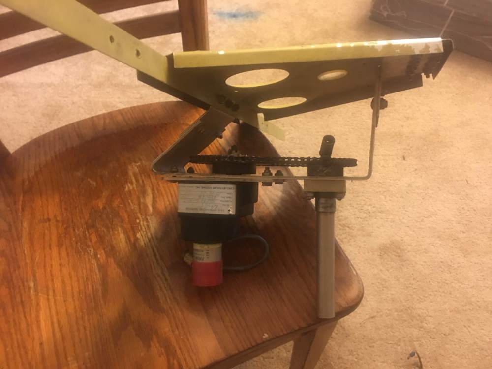

Jerry Pressley Posted June 17, 2018 Report Posted June 17, 2018 I do have an electric trim that attaches to the trim tube and has the bulkhead etc. if this sounds workable i will post photos. I dont have the trim switch 1 Quote

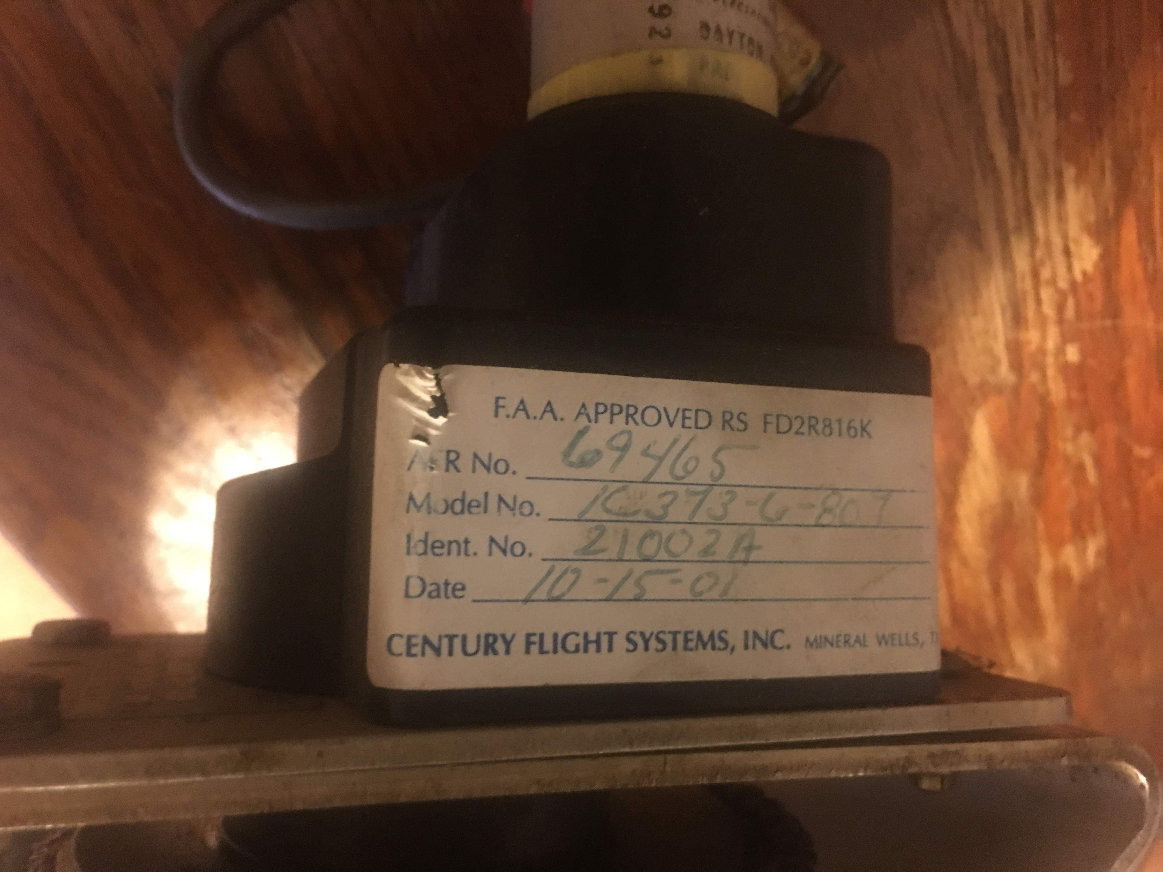

Jerry Pressley Posted June 21, 2018 Report Posted June 21, 2018 photos of trim century 1C-373-6-807 1 Quote
