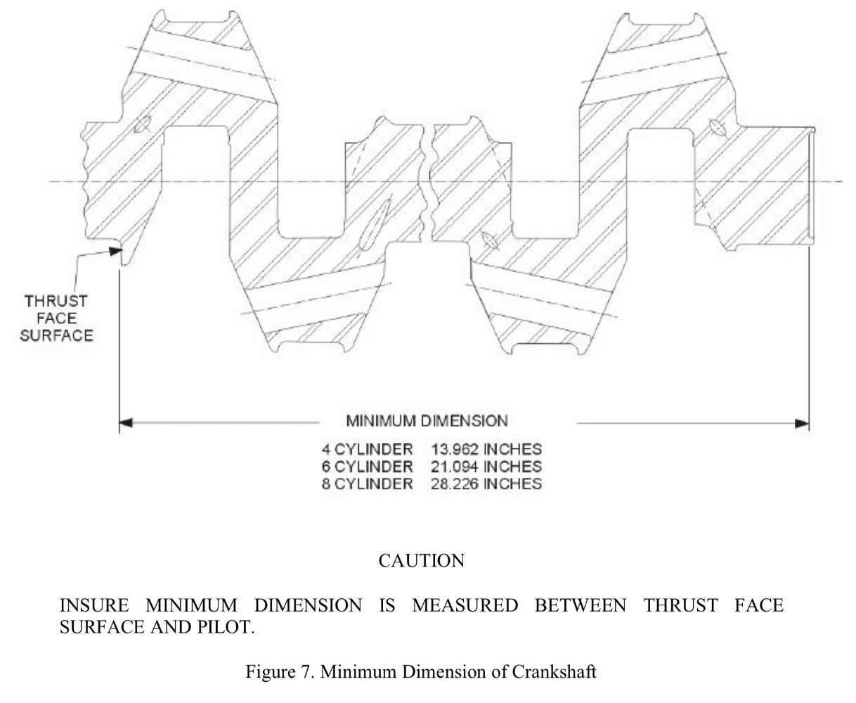

MikeOH Posted January 13 Report Posted January 13 FWIW, here is a link to SB475C: https://www.lycoming.com/sites/default/files/attachments/Crankshaft%20Gear%20Modification%20and%20Assembly%20Procedures.pdf And, page 7 shows the dimension that is out of spec. per the "Final Inspection Reject" paperwork: 1

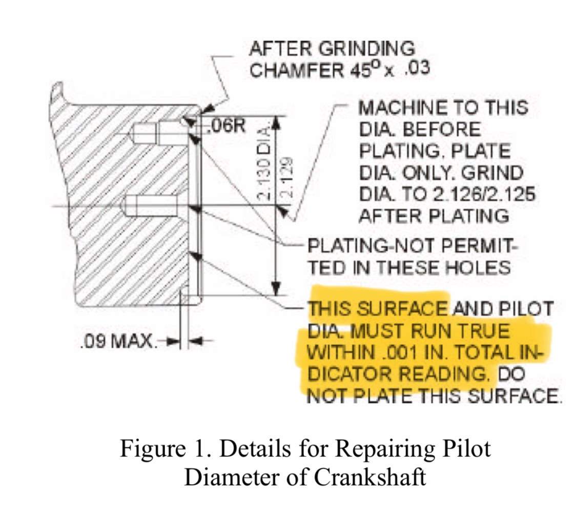

MikeOH Posted January 13 Report Posted January 13 17 minutes ago, Bolter said: That should mean the surface, not the extreme that is bottom of the dimple. If you put the mating part there, is is setoff the correct distance from the other feature on the crankshaft? I think that is one question, but by the look of the photo the area with the dimples has been ground down. If so, the surface is no longer properly flat since there is a 0.001" runout spec for that mating surface (you could also argue the dimples themselves violate that spec), Fig. 1 on page 2:
MikeOH Posted January 13 Report Posted January 13 To ramble on a bit more....if this engine was truly first run, what the heck did they grind and dimple that surface for??? Note that the SB mentions the surface is NOT to be plated, so I'm not sure why anyone would be testing hardness? Even more so, what was the reason to grind down the surface, presumably to then dimple when measuring the hardness below any plating (which shouldn't be there) or surface hardening? It also looks like the SB allows machining the surface by as much as 0.090" to restore the 0.001" flatness as long as it doesn't reduce the thrust face to pilot minimum dimension. I almost wonder if the grinding down in the are where the dimples are is too deep, and 'leveling' that surface would be below the minimum? That is, I wonder if the crank was ruined by someone messing around with measuring that pilot surface for some reason??
