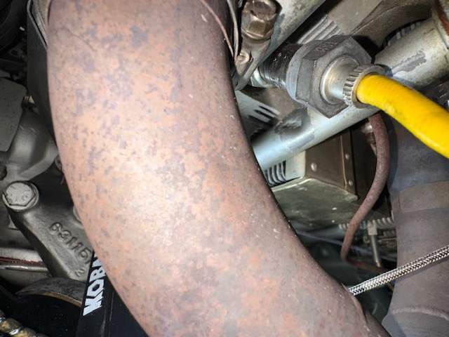

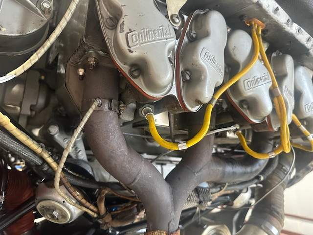

Dustoff49 Posted Sunday at 09:27 PM Report Posted Sunday at 09:27 PM Recently got the Mooney out of an extensive annual. Fixed a bunch of small issues and 3 Major ones. Engine Mount Assembly Repair that required engine removal, New Front Gear assembly from Laser and new push/pull main landing gear tubes. Mooney Service Center completed the work and she flies great. Unfortunately after 5 hours , on what seemed to be a normal runup and takeoff, Tower states I am trailing smoke on departure and even before I had retracted the gear, the tower states it is grey in color and coming from the lower cowling. So I immediately do a 180 tight pattern and safely land. No engine oil pressure lose or high temps. I taxi back to my ramp/hangar and shut down. Exit the aircraft to be greeted with a very large oil leak covering the belly, exhaust and front landing gear. Thank God Above no fire occurred. Push into the hangar and let it cool down. Pull the upper cowling not much to see but definitely oil coming from below an area under Cylinder 3. Upon lower cowling removal I find a severely dented and cracked #3 Intake Pushrod tube. I then find #1 Cylinder Intake tube has the same impression dent nearly identical to #3. Pictures attached. Suspect the Pushrods are also hurt my local mechanic removes both rocker covers and pushrods. Both are heavily damaged and bent. Extremely fortunate I didn't have catastrophic engine failure due to fractured pushrods etc. Now moving on to how this happened. It didn't go into annual with this damage and it has flown fine for five hours until the tube fractured. Based on the impression on the tubes it is suspect when the shop removed the engine they either dropped it or rested it improperly and the weight of the engine leaning on poor supports crushed into the tubes. Regardless waiting for the shop to respond ! 1

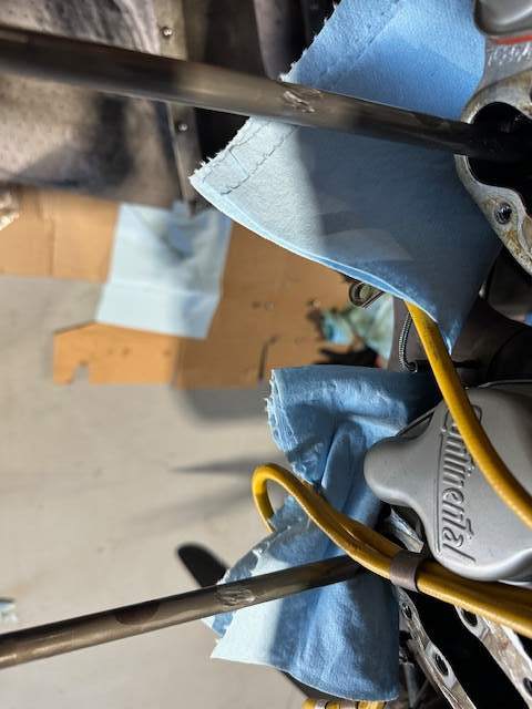

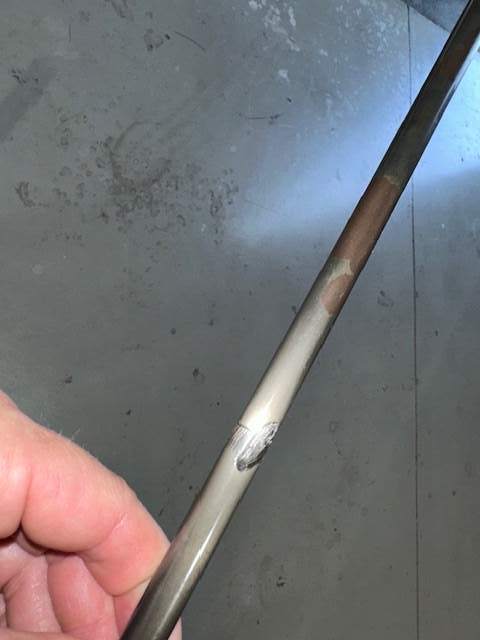

kortopates Posted Sunday at 10:18 PM Report Posted Sunday at 10:18 PM That wouldn’t come from sitting the engine down - the engine probably never came off the crane. My guess it’s from the wrench torquing the spark plug.Dented tubes are not uncommon but denting one to the point it cracks is!Sent from my iPhone using Tapatalk 4
Dustoff49 Posted Sunday at 10:35 PM Author Report Posted Sunday at 10:35 PM I thought the same but the damage is inboard of the plug an inch or so, you would have to really work hard with a boxed-in wrench to dent it this hard and damage the tube & pushrod. Engine was removed in early July and didn't go back till early Sept almost two months waiting on the engine cradle to be fixed. The exhaust system was removed for repairs also so it didn't have anything attached under the cylinders. Hopefully the shop will contact me tomorrow with some answers.

Yetti Posted Monday at 02:28 PM Report Posted Monday at 02:28 PM Kind of looks like the nose of a box end wrench, but does not really line up. Did you have shorter spark plugs in it at one time?
takair Posted Monday at 02:45 PM Report Posted Monday at 02:45 PM Or..were they using a crows foot on an extension? They can be awkward and flail when they pop off…
Dustoff49 Posted Monday at 02:47 PM Author Report Posted Monday at 02:47 PM No its always had the Tempest Plug in it. It could have been a crow's foot 7/8" it would sort of line up. But the impact loosening a plug would have to be massive to dent and bend the pushrod. The impressions close up are the same on both tubes though indicating a tool was used. Possibly the pushrod rubbing up and down initially made the bigger mark then it started rotating again once it clearanced.
Dustoff49 Posted Monday at 09:56 PM Author Report Posted Monday at 09:56 PM Happy Update. The Shop called me this morning with total transparency and owned up to it being an unsupervised intern. He was removing the lower plugs and the Plug wire was slightly seized and rotated the plug out. Instead of grabbing experienced help with a better solution he used a crow's foot with an extension wedged it against the pushrod tube and commenced to torqueing the other 7/8 wrench. I guess he banged it several times. The shop is sending DOM and IA who completed the annual up with all new parts, fixing it , performing an engine oil flush with new filters a few times after the fix and then fly it back down to them after 3-4 hours and once again change oil and filter. After each flush send to blackstone for analysis and determine if any further maintenance is required. I wish more shops had this stance and leadership when things go wrong and its their fault. Hopefully crisis averted but they assured me if further engine damage was done , IE bearings, lifters , etc. they would handle the repairs with no expense to me. Thanks for listening. 10
