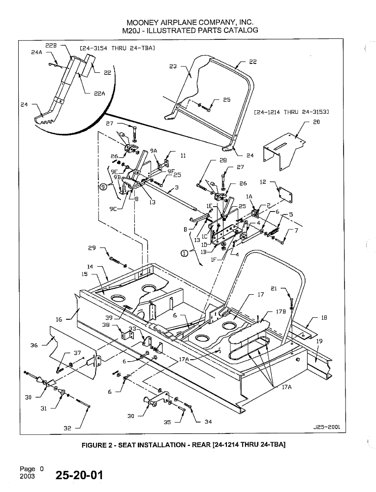

PT20J Posted Wednesday at 03:49 PM Report Posted Wednesday at 03:49 PM There are two designs for the seat back frames as shown in the upper left of the drawing. The later ones move the back further into the baggage compartment providing more rear seat room. The bottom is just a cushion that rests on the plastic pan. Your seats have to be somewhere. I’d go searching for them myself.
