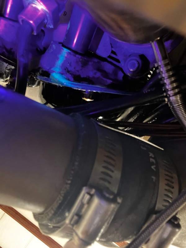

Pinecone Posted August 11, 2025 Report Posted August 11, 2025 Pushrod tube can push out a LOT of oil. Even though they are drain back. On my -SB there was a problem with one O-ring it it pushed out about 2 quarts in 30 minutes. The best way to find the leak is to clean the engine compartment with mineral spirits. Then add 1/2 - 1 ounce of florescent dye to the oil. Run it a couple of minutes and look for the leak with a V light. It works best if you can get it into the shade or a hangar.
